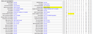

  • Here is a dump of all the registers:   I am not sure if this is any help.
    My current setup:
    Power Source:  USB-C.  {TP4 is jumped with a wire to TP3 to enable USB-C}
    No External Power,  Battery Pack connected.  4 cell 18650 with combine voltage of 15.3V

       ⚠️  Fault Bits:
         - OTG_OVP
         - IBUS_OCP
         - VAC1_UVLO
         - VAC2_UVLO
         - VBUS_UVLO
         - VBUS_OVP
         - TS_HOT_FAULT
      REG 0x1B: 0x100B

  • Hi Don,
    TS_HOT is disabling charge.  Is there a thermistor or 10k ohm resistor from TS to ground to simulate a thermistor?
    Jeff

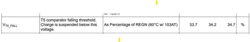

  • Hi Don,
    When V(TS) drops to 34% of REGN, the charger is in TS HOT.
    You can hardware disable TS by sizing the resistor divider to set V(TS) = 2.5V=50%*REGN or use the IGNORE_TS bit REG0x18[0].
    Jeff

    Received my EV2400 in today and got BQStudio up and running.   Lots and lots of data..  What test / collections do you now need?   Attached is register dump and screen shot with the battery plugged in, usb-c connected and plug power on.
    * Created: Thu Jun 26 16:36:41 EDT 2025
    * Format: Register Name  tab Character,\t  Register Address  tab Character,\t  Hexadecimal register value.
    * Device: BQ25798
    * BQZ Container: Charger_1_01-BQ25798.bqz
    REG00	26
    REG01	0000
    REG03	0064
    REG05	24
    REG06	012C
    REG08	C3
    REG09	05
    REG0A	E3
    REG0B	00DC
    REG0D	4B
    REG0E	3D
    REG0F	A6
    REG10	85
    REG11	40
    REG12	00
    REG13	41
    REG14	1E
    REG15	AA
    REG16	C0
    REG17	7A
    REG18	54
    REG19	0032
    REG1B	2F
    REG1C	0A
    REG1D	00
    REG1E	40
    REG1F	10
    REG20	00
    REG21	00
    REG22	2F
    REG23	12
    REG24	40
    REG25	10
    REG26	00
    REG27	00
    REG28	00
    REG29	00
    REG2A	00
    REG2B	00
    REG2C	00
    REG2D	00
    REG2E	30
    REG2F	00
    REG30	00
    REG31	0000
    REG33	0000
    REG35	0000
    REG37	0000
    REG37	0000
    REG3B	0000
    REG3D	0000
    REG3F	0000
    REG41	0000
    REG43	0000
    REG45	0000
    REG47	00
    REG48	19
    Screen Shot
  • Hi Don,
    Congrats on getting the EV2400 and BQSTUDIO up and running! EN_HIZ bit =1 which means the converter is off.  The charger only auto sets that bit in the event of a either low voltage on SYS after power up (it thinks there is a short) or inductor current > cycle current limit which is 7.5A or poor source detection at power up.  The fault flag reports VSYS short or CONVTER OCP or POOR SRC respectively.  Did the fault flags report either event?  Those flags clear after being read.
    Also, watchdog timer has expired so changes to several registers will revert back to defaults.  Until we finish debug you might want to disable watchdog timer.
    Jeff
