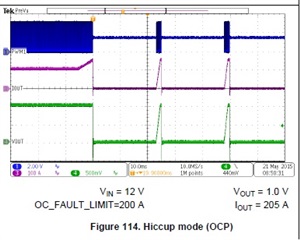

We are using the TPS53647 with a 2-phase CSD95410RRB configuration.
The input voltage is 12V, output is 0.83V, and the OCP threshold is set at 46A (with each phase rated for 30A).
Currently, we are encountering an OCP event, and it behaves as described in Figure 114 of the TI datasheet — i.e., entering hiccup mode.
We have the following questions:
1. Can OCP be disabled entirely? Also, is it acceptable to short IMON to ground?
2. At power-up, we suspect a large inrush current is triggering OCP. Since the load may have very low impedance at startup, is there any way to:  slow down the power-up speed (soft-start adjustment), or temporarily disable or bypass OCP during startup?
We have adjusted the SLEW MODE setting (now 0.34), but there is no improvement at all,
Any recommendations on how to handle high inrush conditions at startup would be greatly appreciated.

  • Start up Slew Rate  0.68 we modify to 0.34 seem not work either
    total cap is about 600UF
    and here is the wavw form on IMON pin
  • Hi Al,
    Thanks for sharing the data.
    It looks like a lot of noise is coupling. Can you limit the bandwidth to 20 MHz on IMON.
    Also, can you please explain the setup condition in details for the 2 waveforms. What exactly is the difference between the two?
    1. In both the cases, the output seems to rise properly. So it is not a start up shutdown issue? Am I right?
    2. Do you have any load on the output in waveform 1?
    Thanks & regards,
    Abhishek
