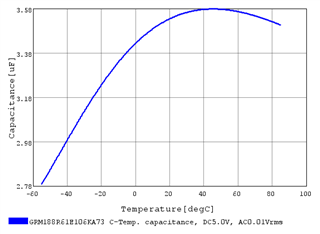

    Your chosen Rcomp1 value is much larger than the calculator suggests.  Also, the output capacitance entered is the nominal value, not the effective value.  Why is that?
    Can you send the part numbers for the 10uF Cin and the 100uF Cout?
    Also, the EN pin needs at least a 15k resistor in series with it.

    Those input caps do not provide the required 5uF effective Cin, under DC and AC bias voltage.  Can you use this cap instead? GRM188C81A226ME01D
    Depending on your temperature range, those 100uF Couts have between 53 and 63 uF of effective Cout.  This is the value that you need to use in the spreadsheet, as it is how much capacitance is actually present in the circuit.
    From your spreadsheet, I picked a 3.01k Rcomp1 resistor.  Then, the 8x 100uF caps give sufficient capacitance.  Ccomp1 is then about 1500pF.

    1. Yes, 3k is fine or 3.01k is a standard resistor value.
    2. I don't think this is enough capacitance, since the effective capacitance will be less than the nominal value.  You need to enter the effective capacitance in cell C26.
    3. No, I think this is too high.  You need to enter the actual, effective capacitance first.
    4. Ok.
    5. Yes, those give enough effective capacitance for Cin.
