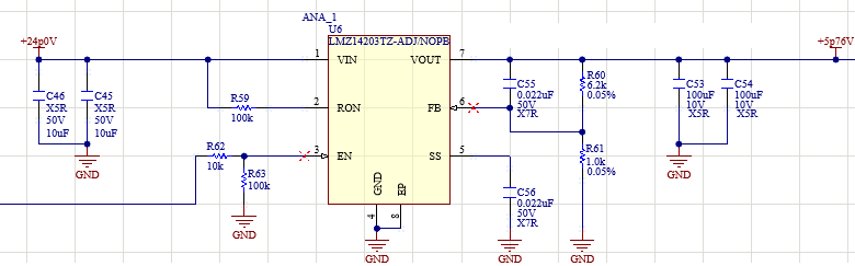

    Schematic excerpt below
    Please note EN is connected to a supervisor chip, which currently is only being used to monitor voltages, and will not disable the chip.

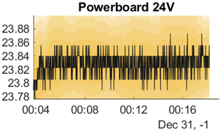

  • Not through a cable. There is input voltage treatment with a power filter and some input capacitors. I have a trace of the input voltage attached. It's extremely steady over time and I do not think it is causing any issue.
    The supply is a 120V inverter capable of delivering 6A.
  • I have solved the instability issue I observed and identified the root cause as a capacitor which was cracked from rework. C55 was causing an intermittent short across Vout to FB.
