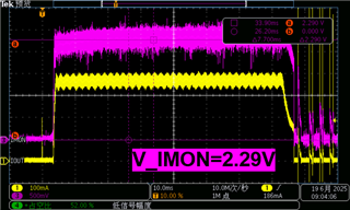

Key parameters: RCS=1.8Ω | | 1.5Ω=0.82Ω,V_IADJ=5V.
Therefore, the theoretical value of Iout is: Iout=V_IADJ_Clamp/Gain/Rcs=2.4V/14/0.82Ω=209mA.

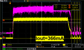

Test 1: IOUT=366mA, VIMON=2.29V when Vin=5.2V, near UV, this triggers the overcurrent protection of the IS pin.
Based on the test results, reverse GAIN by the formula, Gain=V_IADJ_Calmp/(Iout*Rcs)=2.29V/(366mA*0.82Ω)=7.63<<14.
Test 2: When Vin=13.5V, Iout=200mA or so, Gain ≈ 14 is displayed and normal is restored.
Please help analyze why the Gain of CSP-CSN is getting lower before UV. Thanks!

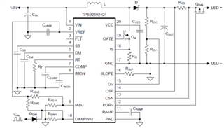

    Schematic and PCB layout.

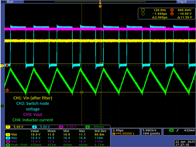

    This is what your scope shot should look like, the channels are labeled in the picture and I need the same time division:

    Please see the attachment. Thanks.
    TPS92692-Q1 issue.pptx

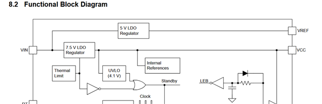

    I know the data sheet for this part lists Vin_min as 4.5V, but you really need to be above the LDO, VCC, and VDD voltages. In the event you wish to lower Vin below 7.5V, you have to power VCC and VDD with a separate power supply.
    Please see the block diagram for more information.

    I think I misdiagnosed this issue and I will investigate it more deeply today. I sincerely apologize. You can definitely run this device at 6V, you will simply need to use a logic-level FET and we may have to tweak a few things to get this circuit to operate properly. Again, I sincerely apologize for the mistake and I am making this a priority.
    Daniel
  • Hi Ivy,
    The device is simply hitting current limit, so you really just need to lower R_IS. I set mine to 150 milliohms.
    A few things to consider:
    1. You may want to increase the input capacitance since you want to ensure stable input voltage at low line because the device will pull a lot of current.
    2. When I initially configured the device, I noticed there was a lot of noise at Vin of the IC so I would consider added a larger capacitor at C20

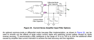

    3. At low line, I saw there was a lot of noise across CSP/CSN so make sure you use a good current sense resistor and maybe look into implementing the filter in the data sheet.
    4. Make sure your customer adheres to the component value calculations in our calculator tool, with the exception of the considerations I mentioned above.
    CH1: Vin (~6V), CH2: VSW, CH3: ILED, CH4: VOUT
    I didnt see any visible flicker on my end. However, the converter will have an easier time operating above ~7V. so you won't witness the weird VSW wave form I pasted above at Vin_TYP.
