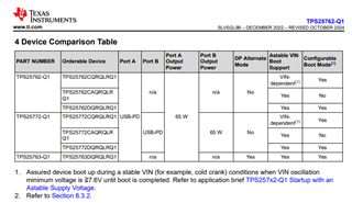

    I searched for the part and found this part number: https://www.digikey.com/en/products/detail/texas-instruments/TPS25762CAQRQLRQ1/22106870
    please check and advise if this one is correct and what is the difference between each part number of this same device?
    thanks
  • Hello Hossam,
    Yes, your understanding is correct.
    There is a schematic you can refer to in Section 4 of the TPS25762DQ1EVM User's Guide here.
    The part you linked is the TPS25762CAQRQLRQ1. This variant will not work without an EEPROM. The OPN of the variant you want is the TPS25762DQRQLRQ1.
    The -C and -CA versions are the previous gen. The -CA version was released after the -C to support cold crank, or Astable VIN Boot, which you can read about it here. The -D version is the latest gen device which supports EEPROM-less operation as well as Astable VIN Boot.
