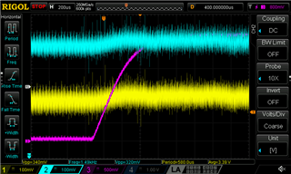

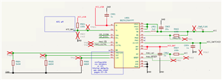

I am working on a device which uses the BQ25120A and shows unexpected behaviour: SYS VOUT is configured to 3.3 V, but during regular operation (Hi-Z mode) I get about 3.4 V. Only when I connect VIN (5 V USB voltage), SYS goes to 3.3 V (and also unexpectedly gets more stable).
The screenshots show SYS (yellow, offset -3.45 V) and filtered SYS (blue, offset -3.15 V) while LS/LDO (purple, offset -1.5 V) is being turned on.
no VIN:
no VIN

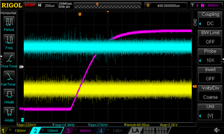

VIN:
VIN
What could be the cause of this?
