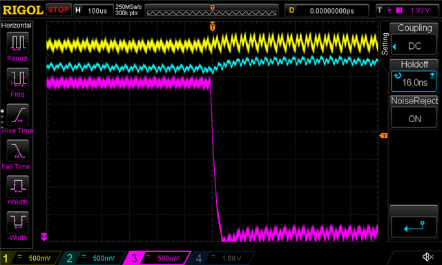

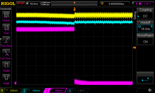

    Here is what I captured on an oscilloscope:
    LS/LDO failing (purple: LS/LDO, yellow: VBAT, blue: SYS):
    LS/LDO failing (div 50 ms)LS/LDO failing (div 100 us)
    SYS failing (purple: LS/LDO, yellow: VBAT, blue: SYS):
    SYS failing (div 10 ms)SYS failing (div 100 us)
    To get a better understanding of what is happening, I'll attempt to recreate the behavior on my end. Just to confirm is this behavior present when VIN is present, or only during Battery-only mode? Additionally, is it safe to assume your battery cell voltage is about 3.6 - 3.8V? Does the actual battery cell voltage differ at all from the VBAT pin voltage?

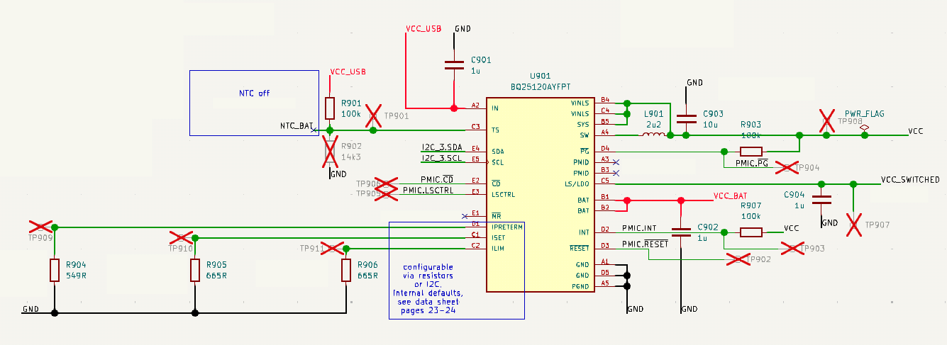

    These are the schematics:
    VCC is connected to some peripherals (MCU, sensors ...) and VCC_BAT is connected, apart from the battery itself, to 2 LED drivers and another single LED.

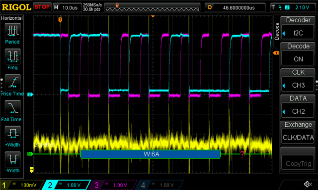

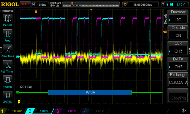

  • These are the I2C waveforms:
    ok:
    fail:
    Yellow is VCC. SDA/SCL are pulled up to VCC with 4.7 kOhm resistors. When VCC drops, SDA/SCL are not pulled as high anymore, but should still be well within limits of being recognized as high levels.

    Regarding communication loss at 3.3V, this is most likely due to the SYS rail falling below the SYS Good threshold on the device. When the Battery is too low to supply SYS, the SYS rail will begin to collapse. Internally, the SYS rail is used for some of the I2C communication level-shifters, so this rail is required for the device to be able to communicate. Since the device also checks that SYS is regulating as expected, a lower voltage than the configured voltage will cause the device to operate as though the SYS rail is not-good.
    This is the most likely cause for the I2C communication loss. If you're still able to communicate with your MCU at lower voltages, you can try setting the configured SYS voltage to a lower value, as VBAT lowers. This should allow you to continue communications even as VBAT falls.
