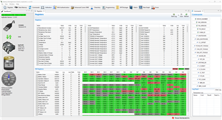

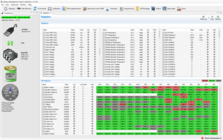

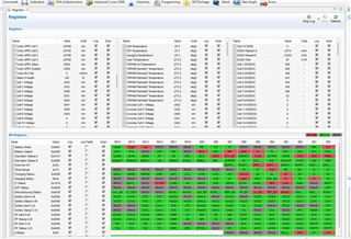

Hi TI-Team,

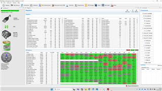

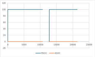

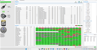

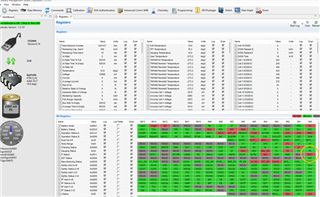

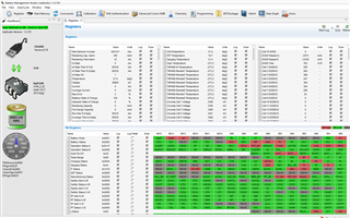

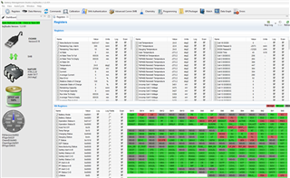

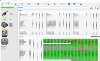

we tried to perform a Learning Cycle but there we are stuck at L Status 0x05 and also we noticed that the SOC is always at 100% and the ASOC always at 0%.
Attached we send some logged Data from a discharge with 2C and the currently used .gg-file.
Is it possible to perform a successful Learning Cycle with the FW Version 0x0002? If not, can you already give me some information about when this will be fixed?
