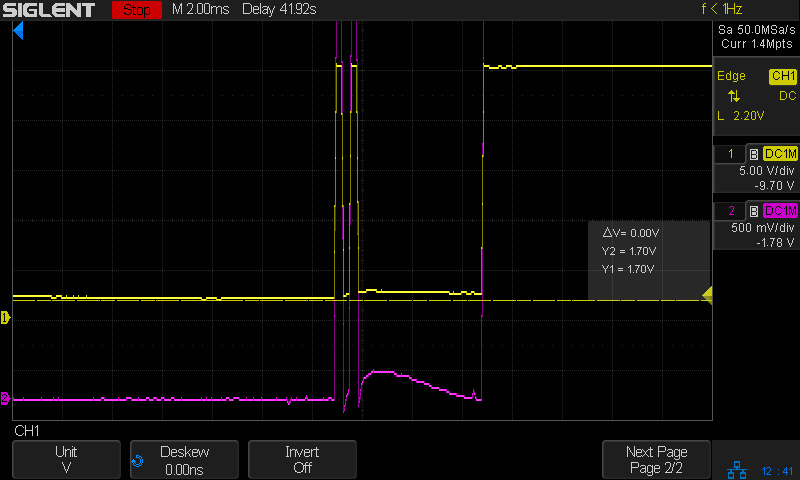

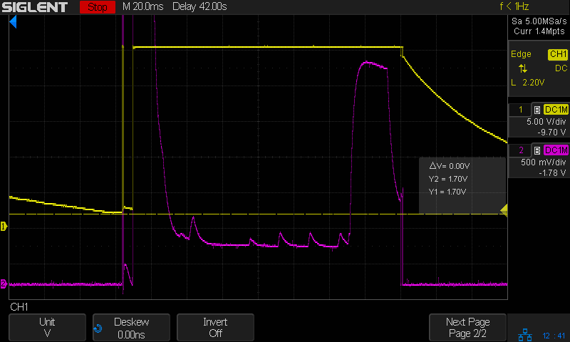

  • Hi all,
    we're giving up on this, with the conclusion that it is not possible to stop the BQ40Z80 from bricking itself from supply contact bouncing. We have added a 22u/35V/X5R capacitor right across the battery terminals (on the BMS PCB), and created a contact bouncing simulator that is able to play back actually recorded contact behavior. We modulate the playback speed to cover a wide range of scenarios. This simulator can easily brick the IC after a few minutes of playback. In the field, the BMS solution is connected to the pack via a connector (JST XH), and this is an eBike application with possible micro contact bounce of these.
    The below screenshots show battery voltage in yellow, and input current (from a 25V bench PSU, with a MOSFET based switch in series) via a 1k series resistor.
    This shows an overview of the sequence. Left of center shows the normal operating pattern: short wakeup every 250ms, longer wakeup every second. Right of center shows the bricked condition.
    Below shows a zoom of the IC bricking itself. The cursor is at 1.7V (undervoltage cutoff of the IC). There is a spike that contains multiple bounces (zoom of that in the following picture), followed by a longer powered time. We think that the fact that the supply voltage 'hovers' around 1.7V during the bounces is confusing the IC, thinking that the flash contents needs to be repaired. The IC startup behavior is different from normal and we think that the large current spike (approx 3mA) at the right shows a flash erase. After this event, the IC is bricked We read all 0xFF from the still accessible flash regions, as explained in the first post above. The entire situation is repeatable. We cannot avoid contact bounce, especially not during manufacture where we solder connections. The contact bounce in field will be suppressed by adding a permanent solder connection instead of the balancer connector. But, unless there is not way to tell the IC to not do what it does here, we truly think that this is a severe design flaw.
    Regards Frank
