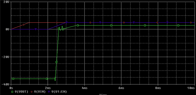

  • Hi Yasuda-san,
    The negative output from the LDO is strange. Can you send your modified .lib file so I can reproduce this result on my end?

  • Hello  Davis-san,
    I attached the fike that we use *.lib  as tps7a20c_sss_use_trans.lib tps7a20c_sss_use_trans.lib( This file is downloaded from your site )
    Could you send me the modified file so that works properly?

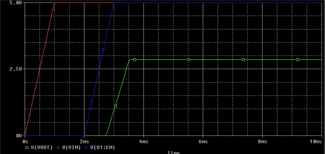

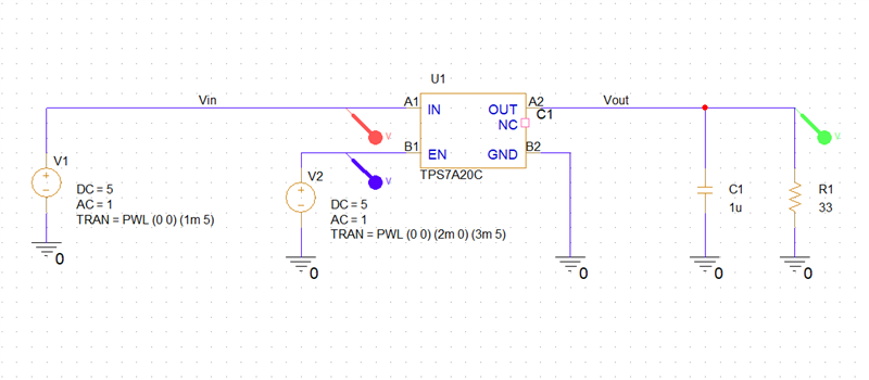

  • Hi Yasuda-san,
    I had a chance to test this in PSpice. I'm unable to reproduce the simulation behavior you're seeing, though it's possible this is due to a difference in the test circuit. Using this circuit:
    and the model file you provided above, I see the following simulation results:

  • Hi Yasuda-san,
    The TPS7A20C macromodel uses a simplified architecture. As noted in the model file, not all behaviors of the TPS7A20 are reproduced. This likely accounts for the difference in model behavior vs. characterized behavior you're seeing.
    It appears that the modelled enable threshold is incorrect - the parameters VENB and EHYS control this threshold. Values of VENB=0.9 and EHYS=0.6 should reproduce the expected 0.9V rising and 0.3V falling thresholds for the enable input.
    Alex Davis
