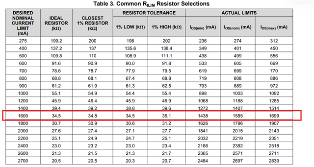

TPS25221: how to improve the accuracy of OCP
Part Number: TPS25221
HI sir
if the ocp is setup to1.6A
i hope the range between IOS(min)=1500mA / IOS(max)=1700mA
according to the Table 3, the worse case is the 1438mA~ 1699mA in 1% resistance
so, if I use the 0.1% resistance, may i know the range of worse case? can meet The range  IOS(min)=1500mA / IOS(max)=1700mA?
