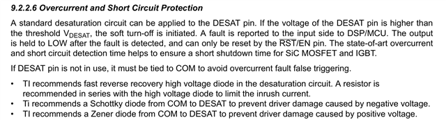

I have shorted the DESAT pin to COM since I'll not be using it
Are the 3 bullet points made after that for DESAT enabled mode or I have to follow them even if I am disabling DESAT
  • Hi Sahil,
    If you short DESAT to COM, you can disregard the bullet points about diodes in the desat circuit.
    If you do not need the DESAT circuit, are you able to use a less expensive gate driver such as UCC5350? That is the best way to prevent nuisance operation of the DESAT circuit.
