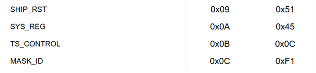

  • Here are the registers.
  • Hi Dan,
    Thanks for sharing the registers values. It looks like these readings were taken while VIN was still connected, and I don't see any issues with your configuration.
    What is the battery voltage while in ship mode? If VBAT is below the battery undervoltage lockout threshold (BUVLO), the charger won't be able to wake up from a push button press.
