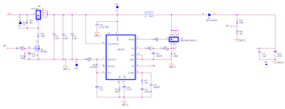

I experience Boost mosfet instability, need your command for schematics
Vin: 37-57V
Vout: 54V, Iout: below 0.6A

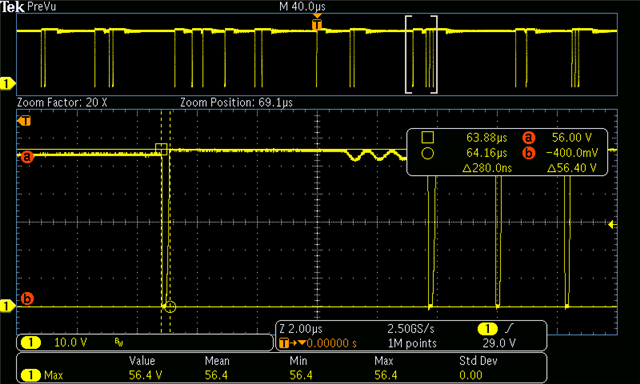

Attached is the picture of Vin 54V, Iout 0.1A & 0.5A
Vin 54V, Iout 0.1A
Vin 54V, Iout 0.5A

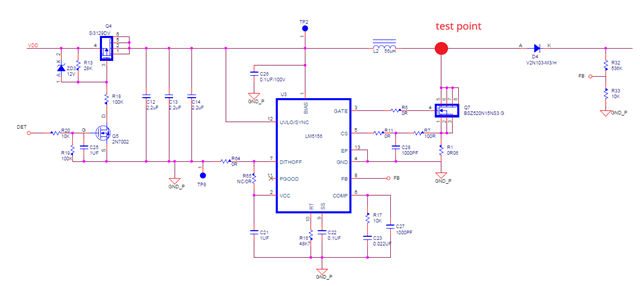

Could you please attach the filled out https://www.ti.com/tool/download/SNVC224 to this thread? This would be the most efficient workflow for us to do a schematic review.
Mounika
Hi Kevin,

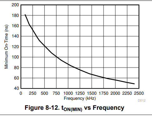

Is the waveform attached is SW node signal? Can you please mark it in the schematic.
Can you Zoom in and see the width of the switching pulse.We assume that the device is in pulse skip mode because of the min ON time.
Mounika

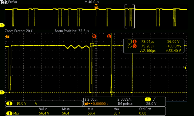

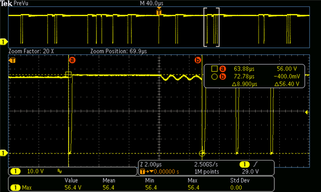

Hi Mounika,
Because the waveform is unstable, I captured a few pictures as attached.
Hi Kevin,
I realised, Vin = Vout = 54V. In this case the device is not switching and skips the cycle. So this is the right behaviour
