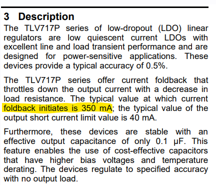

Hi Team
may I know the threshold of TLV717P will trigger current limit?
is it 350mA in first page?

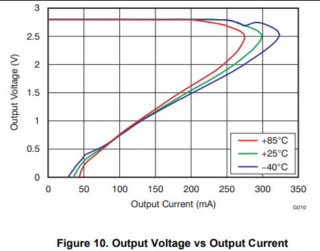

Hi Brian,
The exact threshold overcurrent protection triggers at usually depends on temperature and input voltage.
At Vin = 3.3V (2.8Vout), its dependence can be shown across temperature in the figure pulled from the datasheet below:
But we don't have a guaranteed spec for the current limit.
