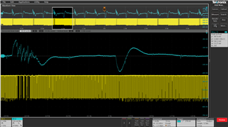

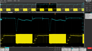

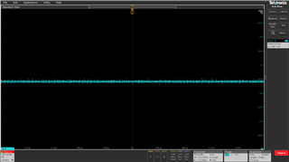

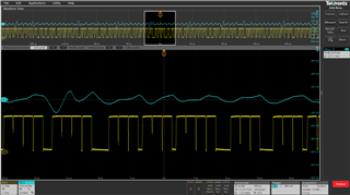

We use the BQ25723 and there is an issue of output oscillation and excessive power supply current loss, resulting in abnormal overcurrent and power failure of the entire machine;
The spec. is input voltage 14VDC, the output voltage is 9.3VDC to 12.6VDC;
The waveform please refer to below:
1. When the system is turned on and in the SHELL interface, the output waveform is displayed. The image on the right shows the AC coupling after unfolding:
2. System startup in SHELL interface state, CH1: inductor phase, CH2: Vout:
3. Shutdown state applies dynamic load to Vout, with current ranging from 0A to 6A, slope of 2.5A/us, and frequency of 1000Hz. CH1: inductor phase, CH2: Vout:
4. Shutdown state applies dynamic load to Vout, with current ranging from 6A to 12A, slope of 2.5A/us, and frequency of 1000Hz. CH1: inductor phase, CH2: Vout:

  • Hi, Liang,
    It looks the current sense is to low. The RAC is 2mohm, only 12mV @6A input. You could use at least 5mohm for RAC and RSR.
    Let me know if this fixes the issue.
    You can also order a BQ25723EVM, thus rule out any layout related noise-issues.
