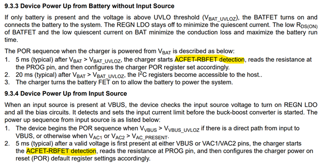

We are mass-producing equipment that uses the BQ25798, and we are experiencing a problem with the power path circuit.
/* ACBR MOS FETs datasheet URL */
RQ3E180BNTB: Nch 30V 39A Middle Power MOSFET
When USB (5V) is connected to IN1 without applying voltage to IN2, nearly 3% of mass-produced units do not output 5V to VBUS.
When I checked each register of the BQ25798, I found that ACFET1-RBFET1 Status was set to '0' (Not Present).
Could you please tell us how ACRB1 determines that it is "placed"?
When does ACRB1 update "placed/NOT placed"?
Regarding the power path circuit, please let us know if there are any problems such as "IN1 gate resistance is large", "FET Qg is high", "VBUS capacitor capacitance is large", or "G-S capacitor capacitance is large".

    The device would look at if ACDRVx is short to ground to determine whether ACFET-RBFET was detected at power on.
    You can refer to datasheet section 9.3.3 and 9.3.4 to when this detection is done.
    Can you share schematic with all the portion related to the BQ25798?

    At power up, the ACDRVx pins output ~40 uA from an internal ~5V rail.  If the voltage at ACDRVx does not rise above 1V in 2ms, the charger decides that the ACDRVx pins are not present.

    The BQ25798 has two power-up sequences: battery only and input source. If I connect a valid battery and complete the power-up sequence "9.3.3 Device Power Up from Battery without Input Source", is it correct to understand that "9.3.4 Device Power Up from Input Source" will not be executed?
