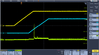

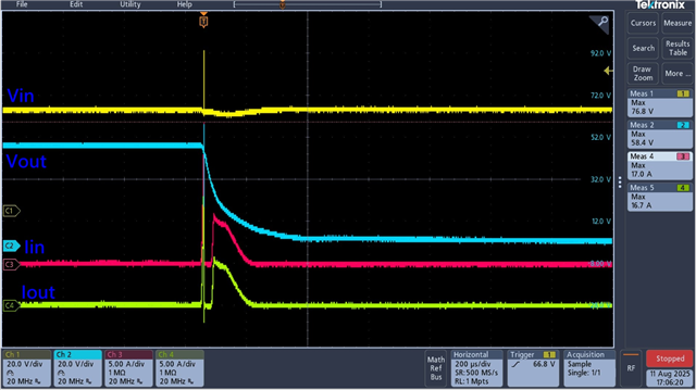

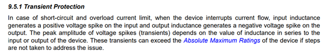

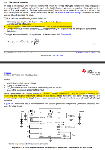

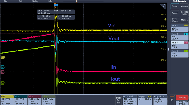

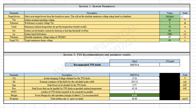

We have encountered two incidents where the TPS26630GER IC failed, resulting in a short circuit between pins 1 and 2 (VIN) and pins 17 and 18 (VOUT).
No abnormal surge voltages or inrush currents have been observed on the input or output sides, and all protection features appear to be functioning correctly. However, internal damage to the IC still occurred.
Could you help identify any other possible root causes we should consider?

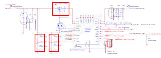

Additionally, please help verify if there are any potential issues with our circuit design.
