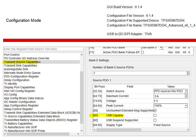

    For the TPS65987, the communication capable bit is directly set in the source PDO 1 field of the Transmit Source Capabilities register, and can be done through the GUI. It is bit 90 of that register.

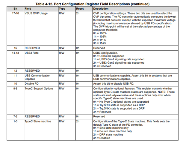

    You may want to explore using the TPS25751.
    The USB Comms Capable bit for this part is actually bit 11 of the port config register90x28). The public TRM has the bit "reserved" but we are in the process of updating it to match the image below.
    So the bit 90 says that USB-C Port with "TPS65987" is capable to communicate over USB data lines. Is this enough?  I can't figure out, how the other side knows which data role the USB-C Port  has, Host or Device,  and whether the USB-C Port is USB2.0 capable only, USB3.0 only, or both? In which register is this defined?
    Actually the same question for the TPS25751: how the other side knows which data role the USB-C Port with TPS25751 has, Host or Device,  and whether the USB-C Port is USB2.0 capable only, USB3.0 only, or both? In which register is this defined?

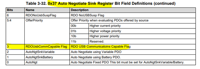

    When acting as source, yes, bit 90 in TX Source caps indicates USB comms support.
    When acting as sink, bit3 in autonegotiate sink (0x37) needs to be used.
    Data role is determined by a couple things, and should be managed by the ports individually. On initial connect, the CC line termination for the ports determines the data role. The port with the RP pull up resistors is the data DFP, and the port with the RD pulldown resistors is the data UFP. For type-C only, data roles are limited to this initial connection. For Type-C PD, Data role swaps can be negotiated using the CC-line PD communication, and each port will keep track of the data roles that are negotiated.
    Two of the first messages sent when USB-C PD communication begins is the source caps message(sent by the source) and the request message(sent by the sink).
    The source caps message uses bit 90 in TX source caps to indicate if the source is capable of USB communications.
    The request message uses bit 3 of autonegotiate sink to indicate if the sink is also capable of USB communications.
    The TPS25751 uses the USB comms capable bit in the port configuration register (mentioned in an earlier response).
