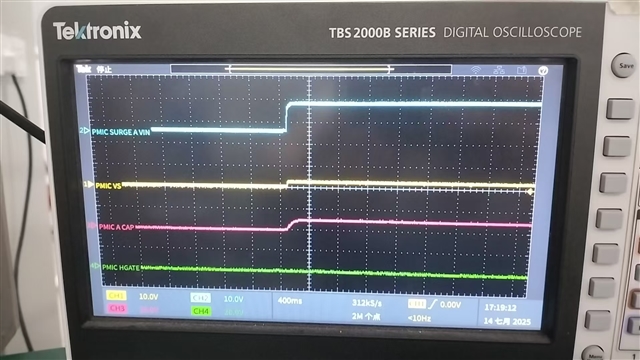

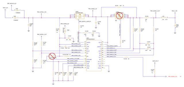

Hi Texas team members:
     have you ever met the problem about LM74930 can't work under low temperature like -30℃~-40℃? We have several domain can't boot under -30℃ because of LM74930 shut down and no power output.
I'm testing this circuit, and could you please give me some support?  thanks.
