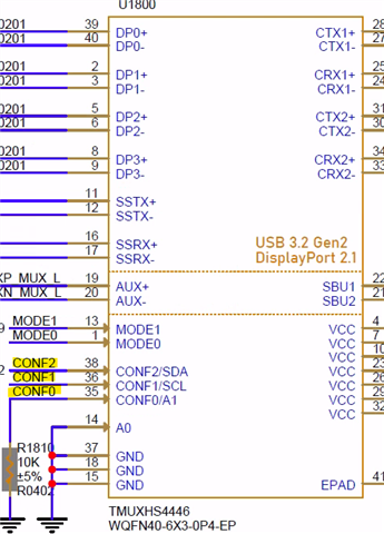

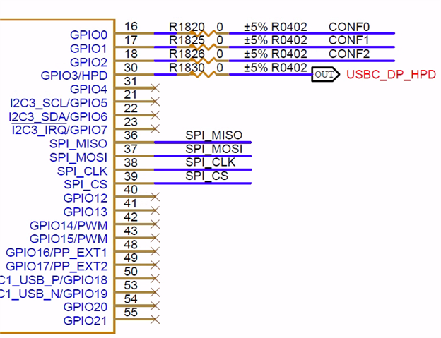

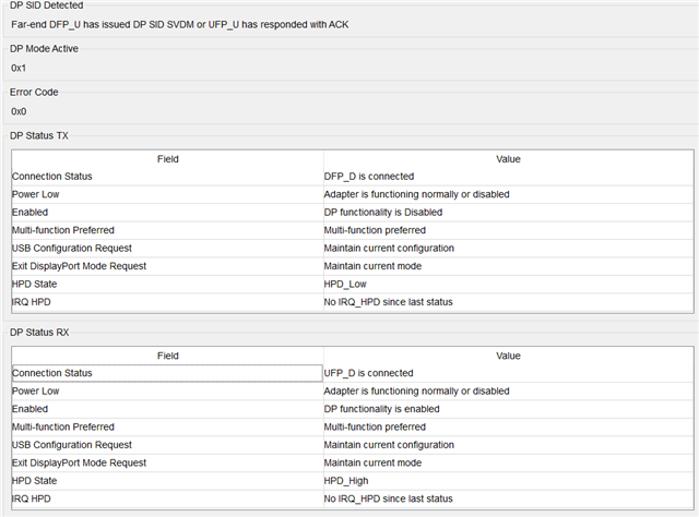

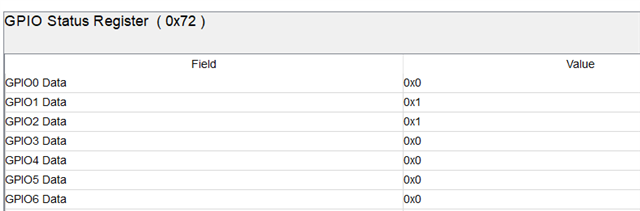

I purchased the TPS65987DDKEVM for further use. From other posts, I learned that the latest GUI for TPS65987DDKEVM is version 6.2.12, while the official website currently shows version 6.1.4. Currently, I have encountered two issues:
1. The problem of GPIO/HPD not outputting normally. Is this related to the GUI version? Could you provide me with the latest version? Thank you.
2. When using the C-DP cable to connect the sink, the EVM, as the source, cannot normally recognize the pin assignment E mode. How should I configure it? Could you please explain?
I need a configuration that can use GPIO0/1/2 as the DP/USB status output, GPIO3 as HPD, and be able to recognize the C, D, and E modes. Could you please provide a project as a future research direction? Thank you!
