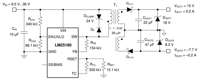

I'm Using LM25180 DC-DC converter (PSR) for below output.
Output 1= +46V and 5mA
Output 2= +14V and 100mA
Output 3= -14V and 10mA
Output 4= -46V and 5mA
All the output have the same ground, please see the transformer design in attached Excel.
So the question is...
1) Is this IC is capable to generate multiple output more than 2?
2) Is IC capable to generate the output like +/- 46V
3) Please see the attached design calculation which I have prepared for above design, if there is any mistake please guide.
4) Is this IC capable to generate the two output with isolation from primary and secondary each other?
Please suggest an IC for above output with 8V to 36V input Voltage.
LM25180_Calculation_4_Output.xlsx

    Please see my feedback below:
    [MA]: Yes, LM25180 is a PSR (Primary Side Regulation) Flyback that regulates the voltage at the primary winding which then is reflected at the output side. I checked your calculation in the spreadsheet and your turns ratio values are good for the output voltages required.
    [MA]: Yes. You can generate negative voltage by referencing your secondary side ground as shown in the schematic below.
    [MA]: I reviewed all your calculations and all of them look good. Good job
    [MA]: Yes, you can generate two or more isolated output voltages with different ground references.
