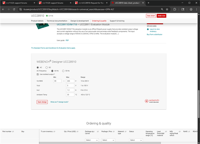

    First in the product page you can find a Webex design tool.  You just enter the input and output power requirements and the tool will generate a schematic and BOM.  You can compare this schematic and transformer connections to your design.
