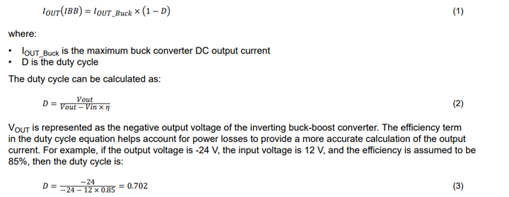

The LM5168 seems to be able to generate -80V from 24V, but the output current cannot achieve 130mA.
Can you suggest a product that can meet this requirement?
An additional requirement is that no transformers are allowed.
