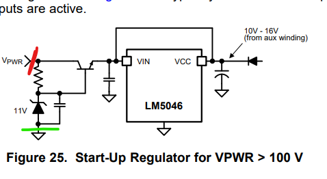

    Regarding the 2 stages, maybe my explanation was not clear enough, here is another take on that:
    Stage 1: NPN linear regulator from 400V to 80V . Just like page 30 from datasheet , chapter 8.2.2.6
    Stage 2: Internal HV start-up built into the LM5046 IC
    In chapter 8.2.2.6 the input voltage is reduced to 11V directly and the internal HV Start-up is bypassed.
    I am afraid that the external NPN will heat up to much and that is why I was considering spreading the power dissipation across 2 components.
    Regarding start-up disconnection:
    Here is the image from the proposed datasheet circuit I was thinking about eliminating the constant power draw through the resistor and Zener diode by disconnecting them either on the low side or high side. I want to to be solid state and not require that many external discrete components. I wad considering P-chan JFET on the low side ( green line) since they are conducting by default with 0V on the gate and then maybe turn it off with a op amp used as a comparator. I can power the op amp from the Vaux.

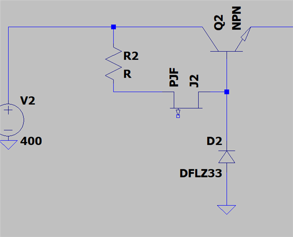

    Regarding the p Jfet this is as of now just an idea, i was thinking of something like this:
    R1 Q1 are like in the 8.2.2.6 chapter, i added J1 a Jfet since that type is default conducting and i was thinking that i can reduce the power loses through R1 D1 ( after the SMPS is running and there is no longer a need for this part of the circuit to be active).
    Regarding control, i was thinking of a few comparators or op amps.
    JFET might not be the best choice but i am very flexible here, other depletion mode device could also be used.
    Alternatively i was thinking of this:
    Same concept but potentially easier to drive J2

    I am not able to understand what you want to do. Please draw these into the circuit with LM5046 to see if we can understand. Note we are supporting LM5046 while not sure if we can help your new ideas. We can try but you need to draw your own idea as a circuit with LM5046. Note we may not be able to help for your new ideas.

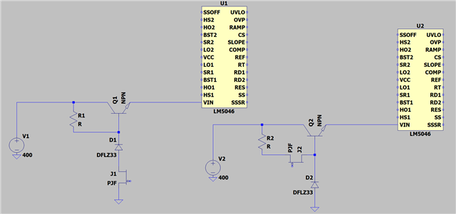

    Sorry for the late reply i got caught some other stuff.
    Attached there is the schematic of what i was thinking :
    Also do you recommend some RC snubber over the Secondary MOSFET or not ?
    These just convert 400V to a voltage in the Vin range of LM5046, yes it is ok. But note if Vin = 400V, you need to use external driver to tolerate the voltage since LM5046 HS1 and HS2 voltage ratings are not able to tolerate 400V.
    These JFETs in your drawing do not have gate signal - how you make them on/off control?

    Regarding the gate drivers i know TI has some half bridge gate drivers that can tolerate 12-15V input signals, it is also a standard pinout, so in this front i already did my homework, this is part of the reason why i responded late.
    As for the JFET control I think i mentioned that i was thinking of using some op amps for that , at this voltage there are only N type so I am no longer sure it can ge done that easy.
