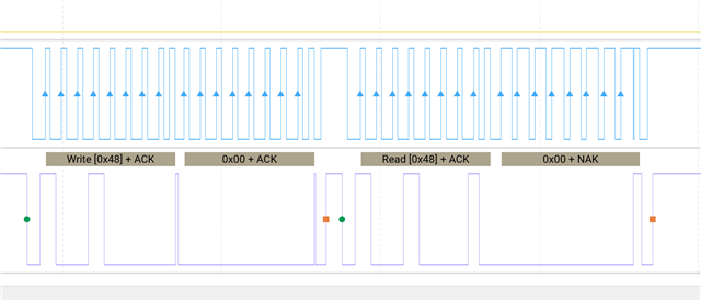

I can watch the I2C bus on a logic analyzer.  The lp8764 is the only device on this i2c bus.  The lp8764 still Acks the I2C writes and reads appropriately and drives SDA low at the appropriate time during reads, so it is not completely dead.
I can scan every address on the I2C bus.  Addresses 0x12, 0x48, 0x49, 0x4A, and 0x4B are the only address that Ack a write.  They all reply with 0x00 when I try to read register 1.

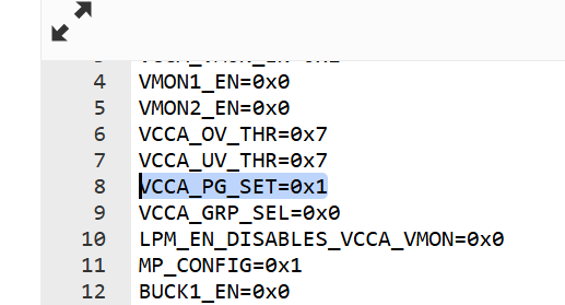

    Attached are the NVM files we used to program the device.  I did not re-program the NVM before it failed or after it failed.  Seems like the issue is somewhere else, but I am happy for you to review our configuration if you have time.
    I sort of wonder if we are beginning the first I2C request too soon after power up and corrupts the I2C handler.  Our MSPM0 processor comes up very quickly and checking the PMIC is the first thing it does.  I doubt the other engineers experiencing this issue were querying I2C that early.
    Obviously this is a scary failure mode.  It would be great to understand the root cause.

  • LP876440C0RQKRQ1
  • Hi Barry,
    Thanks for the shared information. From the NVM file, it seems that VCCA is set 5V. So it explains why it works when you have increased the input voltage. You need to provide 5V input.
    Ishtiaque
  • Thank you for the investigation into our configuration.
    You seem to imply that if the VCCA voltage does not meet the firmware PG setting that the I2C interface will report 0 for all register reads.  Is this the expected behavior?
  • Hi Barry,
    Yes and if the VCCA voltage is 5V then you should supplying 5V input voltage not 3.3V. And if you need to supply 3.3V then you need to update the configuration accordingly.
    Ishtiaque
