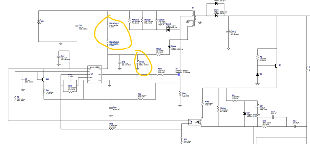

UCC2803-EP: START UP CIRCUIT USING RESISTORS
Part Number: UCC2803-EP
Other Parts Discussed in Thread: UCC2803
Hello
As per below webench start up circuit suggestion,
Input voltage ranges from 180-370V, if i consider 180V as input voltage then the current consumed by UCC2803 during start up is 0.1mA.
CVCC is rated for 35VDC. But as per 370V Input voltage and only 0.1mA start up current, We have to consider 370V as maximum rated voltage for capacitor, isnt it?
