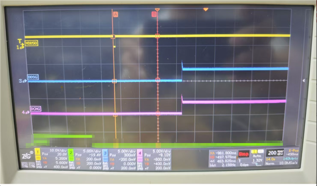

BQ76952: Pin34 of the BQ76952 chip as VDD50.When initializing the BQ76952, VDD50 drop to 0V for about tens of milliseconds
Part Number: BQ76952
Dear TI engineers:
We use pin34 of this BQ76952 chip as VDD50,and VDD50 is generally used as the enable pin of the LDO and may affect the MCU3.3V.
When initializing the BQ76952 chip, the VDD50 was found to drop.As shown as the pciture,the channel 1 is VDD50 ,When the BMS is activated, the VDD50 will drop to 0V for about tens of milliseconds.
Is it related to the initialization process or OTP?
We want to know what is the reason for this? Is there any configuration on the software that could cause this to happen?

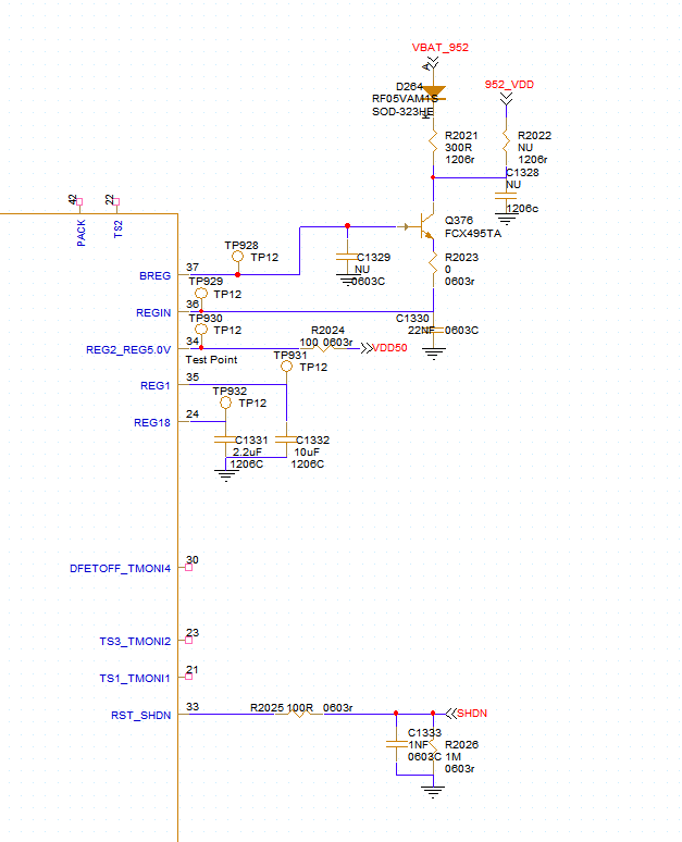

    We are unable to provide the complete schematic . Which pin-related parts of the BQ76952 schematic do you need?
    zehu
  • Hello Zehu,
    Is this issue only occuring during initialization or is it occuring after the device has fully initialized as well? Is REG2 configured to be automatically enabled? Make sure bit 4 in SETTINGS:CONFIGURATION: REG12 Config is set to 1. If this is not enabled, then REG2 will default to being disabled when initializing after reset or deepsleep.
    Could you share the schematic related to pins 33-37?

  • Hi Rohin,
    Thanks for your continued follow-up. We’ve checked the code and confirmed that bit 4 in SETTINGS:CONFIGURATION: REG12 Config is indeed set to 1, so REG2 is enabled as required.
    Additionally, we’ve prepared the schematic related to pins 33-37 of the BQ76952 as you requested.As shown as below.
    Hopefully these information will help identify potential causes, and we’d appreciate your further insights on this issue.

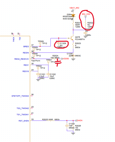

  • Hello Zehu,
    I apologize for the delay.
    What is the purpose of the R2022 resistor and C1329 cap?
    Also, we recommend adding the REG2 cap to ground here as well. Besides these few things the schematic looks fine on this portion of your system. I will be going into lab today to see if we observe this VDD drop during initialization on our EVMs.
    Rohin Nair

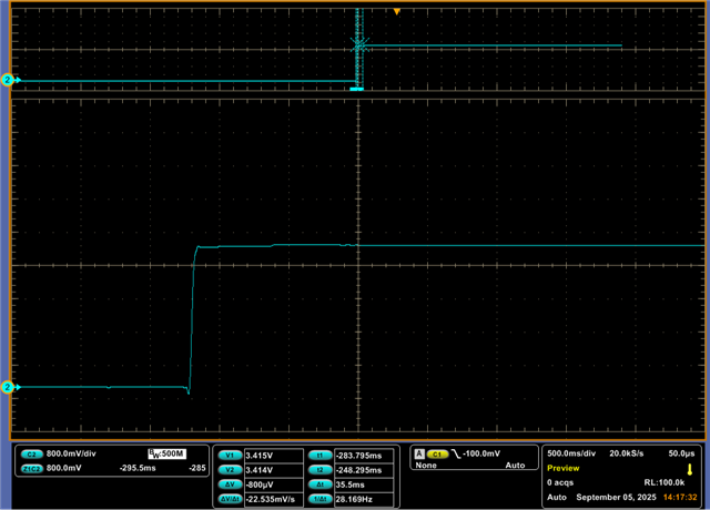

  • Hello Zehu,
    I have used our IC on our bench and our REG2 (your VDD50) never drops for initialization. It stays steady at 3.3V. I would suggest removing that resistor to VSS on REG2 and adding that cap as recommended below. Let me know if this changes anything for initialization.
    Rohin Nair
  • Hi Rohin,
    Thank you for your attention and help with verification.
    We have found that the VDD50 power-off issue is caused by resetting the AFE during initialization. The demo code performs a  reset when initializing the BQ76952. We have the following questions:
    1. Is this  reset mandatory during the initialization of the BQ76952?
    2. Can we replace the reset with a partial reset (by pulling up the RESET_SHUT pin)?
    3. Are there any risks associated with using a partial reset instead of a reset during initialization?
    Zehu
  • Hello Zehu,
    The reset is not necessary as the device should load the OTP or default settings at initial power-up already.
    For more information on partial reset, I would recommend taking a look at this thread.
    Rohin Nair
