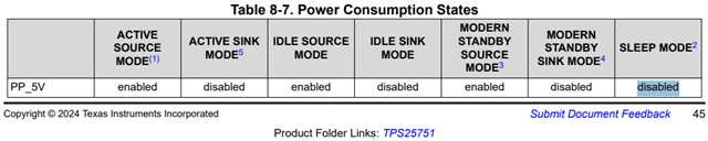

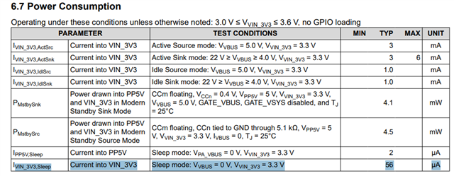

we found that in datasheet that there are two current for sleep mode, IVIN_3V3,Sleep and IPP5V, Sleep, we would like to know the power consumption only considering IVIN_3V3,Sleep or (IPP5V, Sleep+IVIN_3V3,Sleep)?
In my opinion, in sleep mode PP5V should be disable, the power consumption should only IVIN_3V3,Sleep
When PP5V is disable the consumption should be around zero, but why the typ value is 2uA?

    The power path is effectively disabled, but there is a small amount of current drawn on the PP5V path in sleep mode. When the path is enabled and in use it can draw up to 3-A so the sleep current is significantly lower than the enabled mode.
    Sleep mode should consider I_PP5V,Sleepif PP5V is used. There are some sink only applications where PP5V can be grounded, but in all other applications, both currents should be considered in sleep mode.
