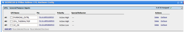

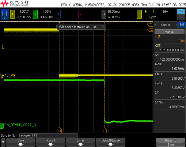

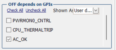

Hi Sir,
I would like to configure the power-off sequence such that EN_RTVDD_0P77_MAC0 is turned off once AC_OK is pulled low.
However, based on waveform measurements, it appears that this setting is not functioning as expected. I’ve tried using a different monitored rail instead of a GPI pin as the reference signal, and it worked correctly.
May I confirm whether this means that GPI pins cannot be used as a valid trigger for power-off sequencing?

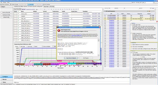

  • Hi
    Please enable the GPI fault response to shutdown.
    Yihe
  • Hi Yihe,
    Thanks for the reply.
    I tried to follow your suggestion, but the following error message occurred:
    Overview
    Application: Fusion Digital Power Designer 7.10.1.0
    Operating System: Microsoft Windows NT 6.2.9200.0
    .NET Runtime: 4.0.30319.42000
    Memory Used: 161.00 MB
    Exception
    System.NullReferenceException: 並未將物件參考設定為物件的執行個體。

    Please let me know if there is any further action I should take.
    Thank you.
    AS9947-72XKB_UCD90320_Main_U190_17d_20250728_test.xml
  • Hi
    can you please try this?
    TI-Fusion-Digital-Power-Designer-7.10.17.zip
    Yihe

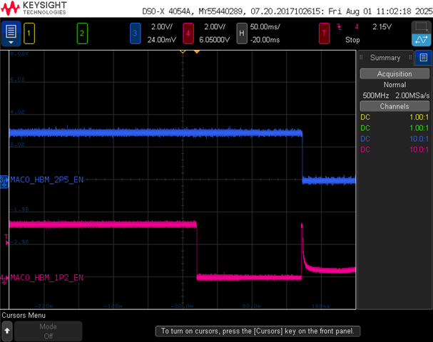

    I have updated the GUI version and configured the fault response to shutdown. However, I found that neither the GPI nor the power rails are able to support the power-down sequence. Could you please help verify if there is any mistake in my configuration?
    For example, MAC0_HBM_2P5_EN does not pull low along with MAC0_HBM_1P2_EN.
     UCD90320 3.0.0.3330 Address 17 Project File_20250801.xml
  • Hi
    YOu have to enable the fault shutdown slave so that rail of MAC0_HBM_1P2_EN can shut down other rails.
    Please refer the quick guide attached, especially on fault response section.
    0871.UCD90xxx Quick Guide.pptx
    Yihe
  • Hi Yihe,
    Thank you for your suggestion.
    The Power-down sequence is working as expected.
