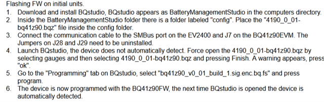

I jsut received the EVM and tried setting it up following the guide present on the EVM.

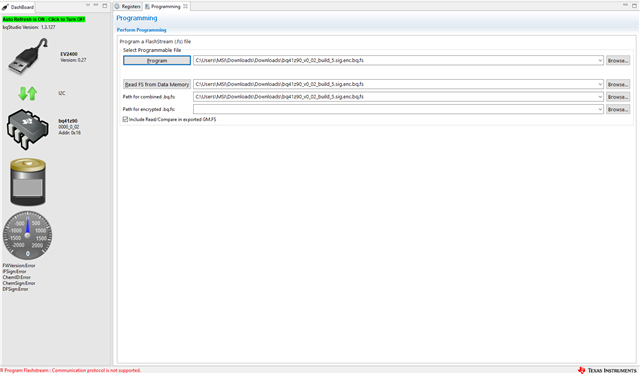

I can follow the process till step five, but I am not able to flash the firmware onto the board. When I try to program, I am getting the following error "Program Flashstream : Communication protocol not supported"
As you can see in the screenshot, BQStudio thinks that I am trying to communicate via I2C protocol, however, I am using SMB to communicate with the gauge. I am using the J11 on the EVM.
I used another BMS that I have and it confirmed that I am using SMB port to communicate on my ev2400

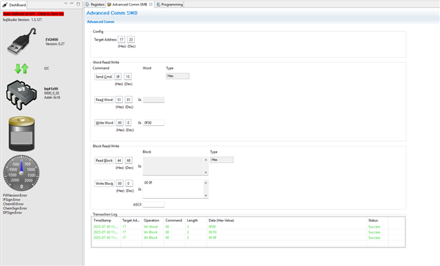

    Send Cmd 0x0F00, then try to flash the FW.
    Diego
  • Hi Diego,

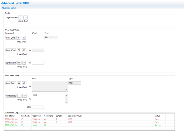

    I tried sending the command 0x0F00 via ManufacturerAccess(), but it failed. Then I sent the command 0x0f directly as the app would only allow a single byte.But still I can not program the board. Please check the screenshot attached,

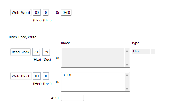

    Sorry, send cmd 0x0F00 to cmd address 00.
    Diego
  • Hi Diego,
    I tried sending the commands to 00 as well. The same thing happened again. The gauge seems to believe that it's in I2C mode and not SMB. Please see the screenshot below
    Are you connected to the SMBus port on the EV2400?
    I will try to recreate this.
    Diego

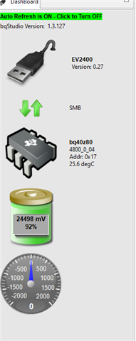

    I have programmed numerous Gauges and Monitor using the EV2400 on the BQ40z80EVM using both the SMBus out and I2C out from that board. So I am sure that this method atleast works with other IC's. Theoritically if both EV2400 and the MSP on the BQ40Z80EVM  have the same firmware I should be able to communicate using it.
    Here are some pictures of my setup to help you further
    1. BQ40Z80EVM with BQ41Z90EVM.
    In this case the Battery Management Studio detects that I am connected via I2C(Please check in the picture I sent in the thread above)

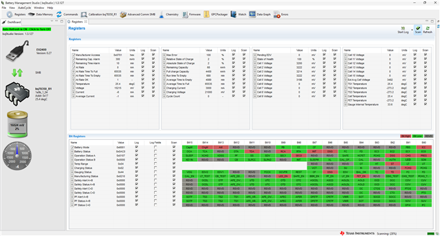

    2. BQ40Z80EVM with BQ76920EVM+78350 onboard.
    In this case I am able to communicate with the BQ78350 flawlessly as seen below.

    Got it thanks, if you force open BQstudio on an SMBus device, can you communicate SMBus through advanced comms?
    Diego
  • Yes I can communicate with other SMBus devices via the advanced comms(and I don't need to force open BQStudio).
    So far I've only faced problem with the BQ41Z90 EVM.
    Although I can not update the firmware in the BQ41Z90, in the screenshot provided above I tried communicating using the advanced Comms and some of the messages did seem to go through (as I can see the status as "SUCCESS" in the logs.
    If you can communicate to the BQ41z90EVM via advanced comms, you can configure everything this way until you get your ev2300 back from your colleague.
