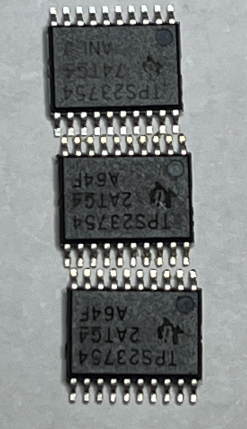

I have 10 new pcba from China built with no changes but  4 out of 10 are unstable and hiccup for no reason.
I've changed lots of things and finally replaced two ICs with Digikey Stock TPS23754 parts and the hiccuping went away. The top IC branded 74TG4 ANLJ is the Digikey part.
So far 2 out of 2 replaced ICs and the "hiccup" problem went away. The TI IC was the last thing I suspected.
Please let me know.
Thanks!

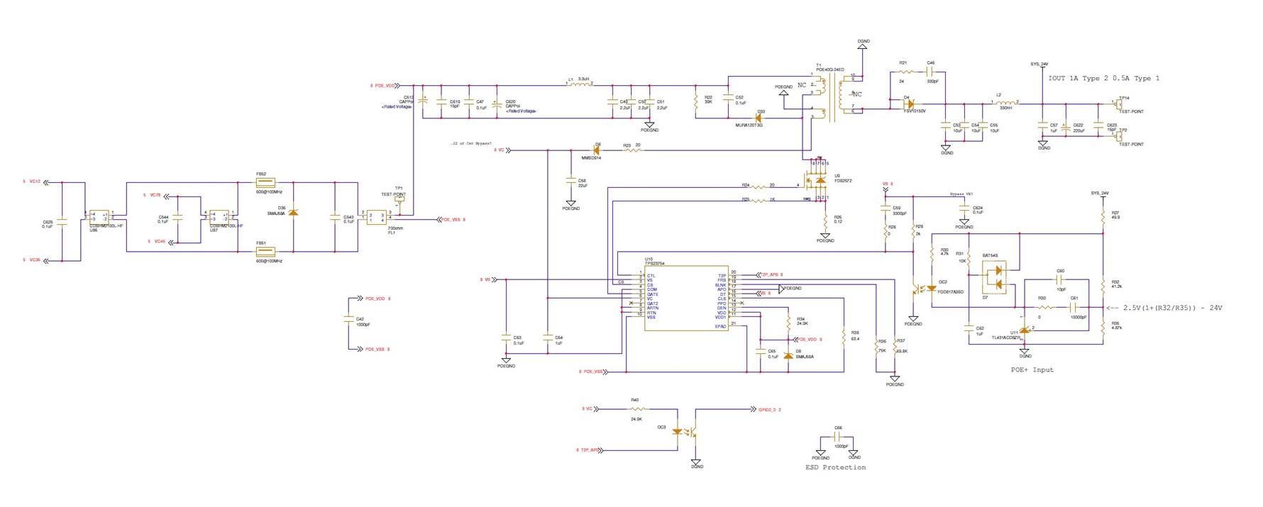

    Could you share the schematic of your PD + DC/DC circuit? I would like to see if there are any application related concerns, and maybe minor chip feature changes can make a pass/fail.
    Also, when hiccup happened, were you running a test with a standard PSE or a injector/bench power supply?
    Diang

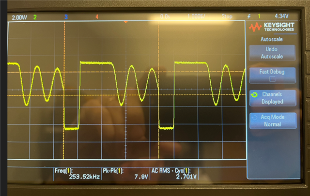

    Our China CM has made nearly 30 of these pcba with this power supply and this is the first instance of 10 pcba built we had 6/10 pcba with this "hiccup" error, and all 10 pcba had glitchy behavior to some extent. Some boards you can hear the "hiccup" audibly. I tried two days off and on to fix this by following data sheet and your advice for an earlier issue and finally changed the IC and the issue went away.
    Based on the branding of the two ICs I replaced compared to the top IC in the image I see a difference.
     These are not "minor" pass fail corner case, these devices all had issues to one extent or another and replacing the ICs with Digikey parts corrected the "hiccuping" completely and the drive waveforms of the device were corrected.
    PS: Our CM spot buy these suspect IC from http://www.ickey.cn for your information.
     Waveform of FET at xfmr primary with suspect IC.

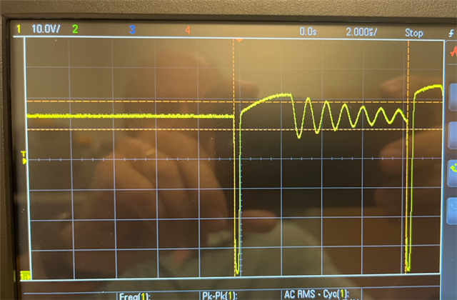

     Waveform of FET at xfmr primary with Suspect IC replaced with Digikey, no other changes to pcba components.
    We got the same results on TP Link POE+ switch or PhiHong #: POE60U-1BTE-R IEEE802.3BT - POE 60W injector.
    I could not attach a file so this is all I can give you for a schematic.

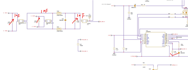

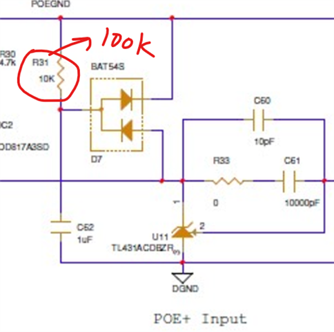

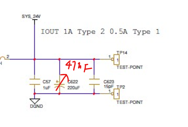

    Thanks for your information. I saw two things could be related:
    1. Start up delay is not enough and output cap is too large: You may use a 100k R and a smaller 47uF output cap
    2. The input cap is too high. Stannard needs 80 - 120nF input caps. It is recommend only keep the 100nF near VDD-Vss and changes other caps to 1nF instead.
    Diang

    With the defective IC installed what we found was that on some boards removing both 22uf caps then the IC would not reboot the POE Supply, but would still "hiccup" constantly with that odd waveform xfmr primary. Before we removed the two 22uf caps the POE+ supply would constantly hiccup and reboot.
    But with new IC (no other change to the PCBA components-virgin boards) the board operates quite well and we can load it to the maximum VA capability (Since wave 20 W RMS 1 kHz into 8 ohms) with no problem at all and it will operate its on board DSP, Ethernet, 24V, 5V, 3.3V and ARM processor no issues.

    Personally I would have some concerns especially the 24V Vout with 220uF cap will cause too much inrush energy. But if you had tried multiple ways to check, and A-B-A swap method shows the issue follows with PD chip, you could replace all chips and consider submitting a failure analysis to check if the chips are not good.

    Today I have concluded that the issue with the IC/PCBA was that the IC pad was not adequately soldered to the copper pad beneath it.
    What I did was to take the boards that were “hiccupping” and apply liquid flux to the TPS23754 IC and reheat the TPS23754 IC with a hot air gun until their solder melted and then allowed the part to cool. I did not remove the part only heated it.
    After this heating/reflow cycle the IC worked as intended and the “hiccupping” went away.
    I have corrected 5 boards with this method.
    With no audible chirping and the waveform of the FET driving the primary was stable.
    In a quiet room it is audible at a distance.
    I consider this matter closed and the TPS23754 ICs to be OK.
