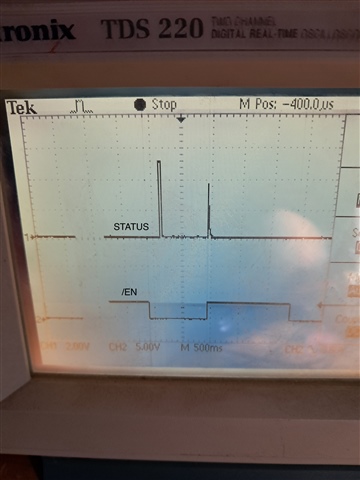

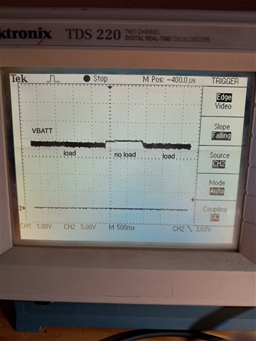

My design is made of one BQ25306 for charging 2 // li-ions cell. When my system need power (around 10A), i drive /EN pin to high level for deactivate the charger.
The STATUS pin is pulled high to REGN, and the level goes high but just for 100ms and is then pulled down by the chip to low level, while /EN pin is still high.
When /EN is driven to low, i can see a pike on STATUS pin (low-high-low). What can explain this behaviour ? From my understanding, STATUS pin level must reflect /EN pin level.
