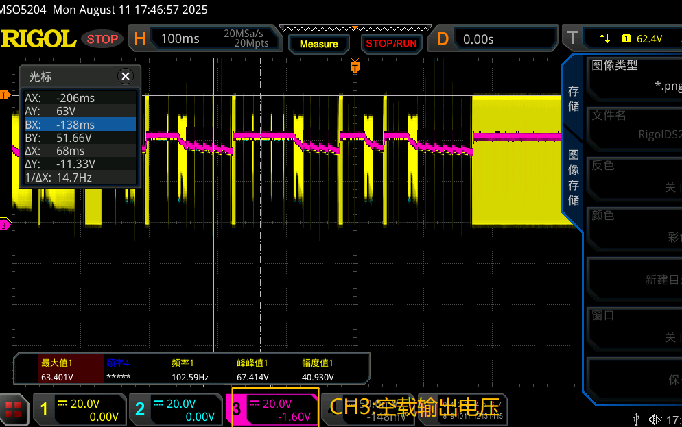

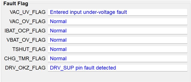

My customer is using BQ25820 in Humanoid robot battery buckup bag and met an issue that STAT1 and STAT2 led is lighting.
They find that there is no TS issue.
Q1: How do they figure out if there is a safety timer fault. what is the safety timer fault.
Q2: Could you please help check the schematic and see any faults.
05_charger(1).pdf
Below is the words on the left and top of the schematic.
1. Overvoltage charge cutoff voltage is not set;
2. Undervoltage charge cutoff voltage is 47V;
3. Set charging voltage to 41.9V;
4. Bus current limit is 6A;
5. Charging current is 2.5A;
6. Charging input voltage is 44.8V~67.2V, battery 10S ternary lithium
