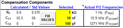

Here's a summary of the main components I'm using:
Cout: 10uF x9 (MLCC), 4.7µFx2 (MLCC)
Cin: 10uF x6 (MLCC)
L: 1uH
Rs: 5 m
Rt: 48.7 k
Css: 0.1uF
Cslope: 56 pF
Rc: 2 k
CC1: 4700 pF
CC2: 330 pF
Mode: 93.1 k (CCW / Hiccup enabled)
