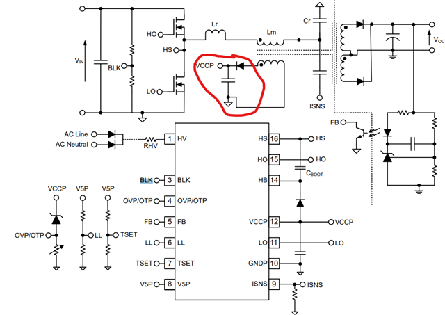

We wanted to go with UCC256601 for our 700W CVCC requirement and started going through the datasheet, design calc and reference board documents and we have few doubts. Requesting you to please help.

5.We want to go with this design without external aux power either for primary or secondary control circuit. So we will have Aux power from main LLC transformer only. Please let us know the challenges we need to face.

    5. This can be achieved easily by VCCP pin, as shown below:
    However, the problem is in the startup. In the startup, VCCP will not be high enough to power up the IC as Vout has not been built fully. For that HV pin can be used to power up the IC at startup.
