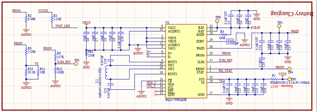

We are using BQ25798 2s battery charging (7.4v 1200mAh), we are connected 5V/2A adapter. the BQ25798 is in default mode and the host device stm32 is only interface for getting battery voltages from ADC only when I power ON the device.
Sequence 1 :-mode sequence when device is turn ON and BQ25798 is charging (REG_RST reset(9h)->stop watchdog timer(10h)-> enable ADC(2Eh)->read ADC value(3bh) for battery voltage in 2sec timer)
Sequence 2 :-host mode sequence when device is turn OFF and BQ25798 is charging (REG_RST reset(9h)->Enable watchdog timer(10h))
issues:
1)Condition when BQ25798 is in autonomous mode or default Note when we connect i.e. replace (6.65v) battery and I don't power the host, the battery gets charge successfully at 8.4v and state led turn off indicating charging complete. But when I replace new battery (6.65v) and restart charging sometime the battery doesn't charge even the state led is also on continuous.
2) Condition when BQ25798 is charging in autonomous mode or default and I turn ON (Sequence 1) the host check the ADC battery voltage value and power OFF (Sequence 2) the host, the battery charging stops, but state led remains on.
3)While continues testing with above 2 conditions my  BQ25798 gets damage and vsys shows 0V even my battery voltage is 8V.
4) What is actual voltages of below pins on default condition when charger connected or charger disconnected (TS , ILIM_HIZ, REGN, PMID, BQ STAT PIN NO 1).?
5)Also check if there should be any modification in the schematic. also suggest us if NTC and CSD is required or not.
Please help us with resolving issue.
Thank you.
I hope you will resolve all my queries?

    For 4, TS and ILIM_HIZ are pulled up to REGN.  When power is applied at VBUS, REGN should be ~5V. PMID=VBUS in charge mode.  STAT pin is low when charging, high Z when not charging and flashing at 1Hz when there is a fault.
    For 5, I do not see any obvious issues other than the ferrite beads. Is F1 on SYS node a ferrite bead?  Is it really only rated for 500mA? Is FB1 really 220ohm?  If NTC is not needed, TS function can be hardware disabled by using same sized resistor divider from REGN to TS  to GND. If by CSD you mean input MUX FETs then no.

    for point no5 F1 on SYS is PTC for for protection purpose we added.
    Is FB1 really 220ohm? it is 220ohm & 2Amp supported.

     Did you follow the datasheet layout recommendation?  YES, we follow all recommendation as per datasheet
    We are only Few additions of circuit as see above attached schematic VSYS terminal PTC add (PSMF050X-2 0.5A 6V 500MA) for protection,
    instead on NTC we add 10k fixed resistor R11.

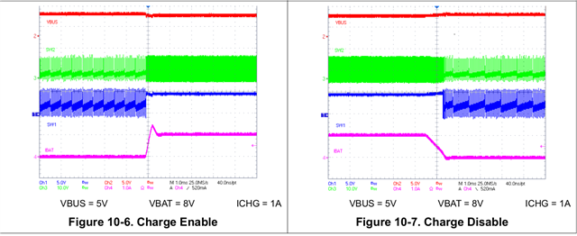

  • This waveform is from the BQ25798 datasheet.
    this image from BQ25798 Datasheet.
    In the above video:
    CH1-SW2 & CH2-SW1
    When the MCU is ON & then we connect the charger for the first time, at that time SW1 & SW2 switches correctly & the battery starts to charge. But if we disconnect & connect the charger 2nd time , then charging will stop.
    Also, when we charge the battery in the MCU off condition, then the battery charges correctly.
  • Hi Niketan,
    What do the status and fault registers in REG0x1B through REG0x27 as well as REG0x0F report at this time?
    Jeff
