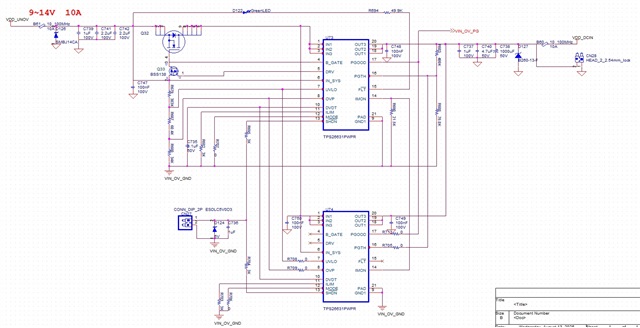

hi, We are working on a design related to eFUSE and hope that the rated output can reach 10A. As TPS1686 cannot be ordered yet, we would like to use two TPS26631 in parallel. We would like to further understand some design details in the application notes<<Parallel Operation of TPS2663 eFuses>>'.
Can you share schematic and layout files for the "Figure 3-1. Evaluation Board with Four TPS26631 Devices in Parallel" mentioned in the notes?
thank you!
www.ti.com.cn/.../slvaf13.pdf
