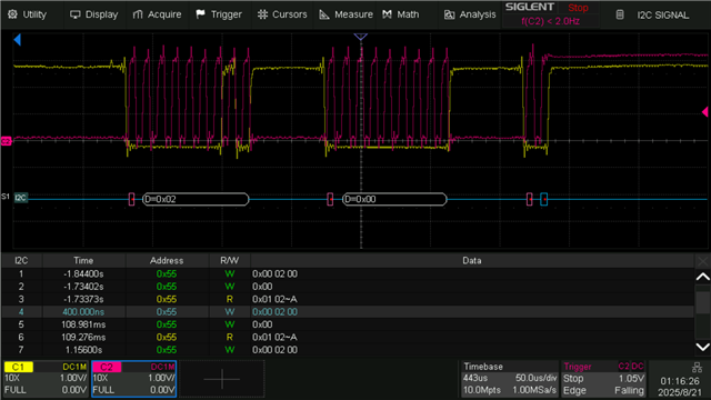

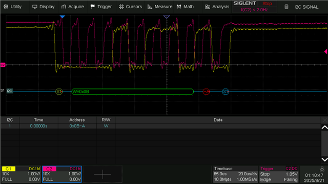

  • This is what I get when I try to write from bqstudio.
    For comparison, here is a successful FW_VERSION command with the same setup:
  • As for flashing it myself, I have the c library running on a raspberry pi. Here is the result:

    I'm pretty sure I know why it's failing, and it's the same reason my code was failing. It's because the image file tries to write the checksum to one command instead of two. There is a two part checksum after every data block write that is meant to go to registers 0x64 and 0x65. The write command is like:
    W: 16 64 35 38
    So it would write to bootrom, with the start address of 0x64, and it's assumed that 00 would be written to 0x65. However, this is not what the bq34z100-R2 wants. It wants two separate commands:
    W: 16 64 35
    W: 16 65 38
