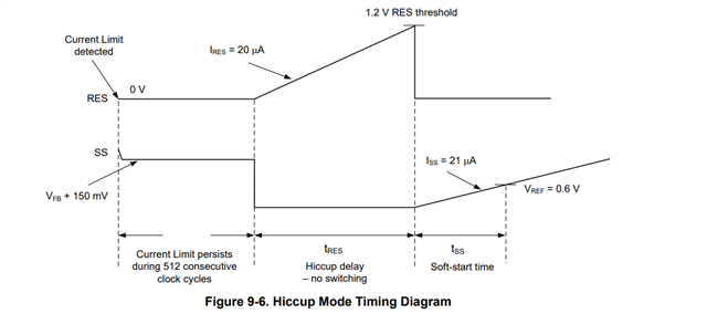

            If the output voltage exhibits a sawtooth switching waveform, the RES pin outputs pulses, and VDDA outputs 5 V, what could be the cause of this behavior? How can this abnormal condition be resolved?

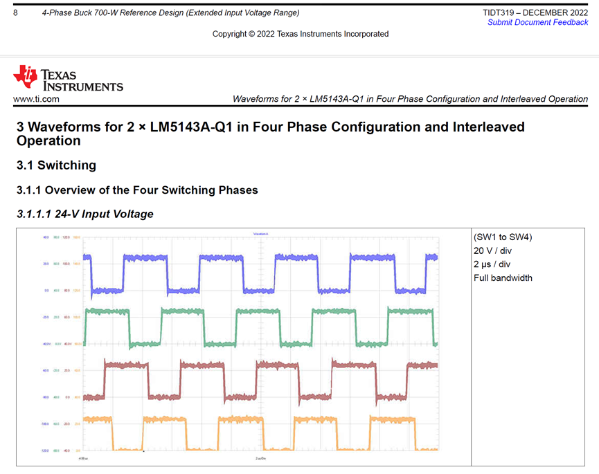

        4. 4-Phase Synchronization Issue
           We are using two LM5143A-Q1 devices to achieve a 4-phase synchronous buck configuration. Input voltage is 25 V, output voltage is 15 V, and there is no load. To verify the 4-phase synchronization, we measured CH1_SW1–PGND, CH2_SW2–PGND, CH3_SW3–PGND, and CH4_SW4–PGND. The CH4_SW4–PGND waveform does not match expectations (we expected SW3 to lead SW4). Measuring CH4_SYNCOUT (same as CH4 waveform) relative to SW1, SW2, and SW4 shows that the phases are not in the expected 90°, 180°, 270°, and 360° sequence. The ideal waveform should match the reference waveform in the TI documentation.

    If you're seeing pulses at the RES pin, this most likely indicates that the current limit protection is being triggered. This additional data point would help us understand if the issue persists across different load conditions or is specific to higher currents.

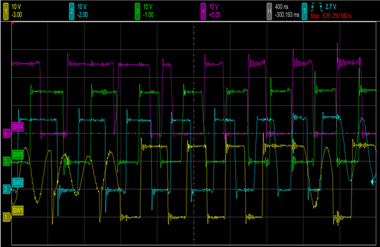

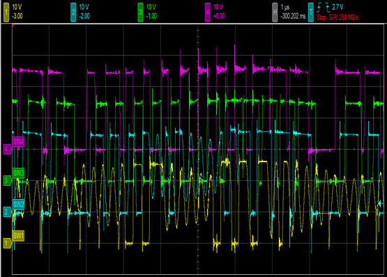

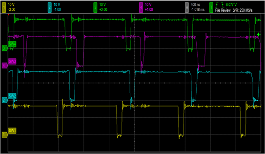

  • Hi Onkar:
      Apologies for the delayed response. The attached figure shows the SW-node waveforms at a 5 A load.
    Could you advise on the possible cause of the oscillation seen on SW1 and SW2?
    We also observe that SW1, SW2, SW3, and SW4 sometimes switch in order. Is this behavior expected?

  • Hello YUMING
    It appears to be a instability, need to verify power stage component and compensation network. Could you please share direct Quickstart file itself, as we don't have google drive access.
    Meanwhile you can try increasing output caps and see if it helps

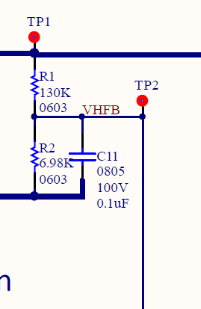

  • Hi Yuming
    Do you have the similar FB configuration here for 4 phase design. Could you please remove 0.1uF cap at FB node and try. This cap will add a pole in to the loop and might lead to instability
    Thank you

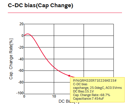

    --> The ceramic capacitor model is GRM32ER71E226KE15L. Apologies for not providing the complete schematic earlier — please find the full circuit diagram below. In our two-phase synchronous buck converter testing, the output (Vout) was initially configured with eight 22 µF ceramic capacitors. When the load current exceeded 5 A, significant output voltage ripple was observed. To investigate, we added a 220 µF electrolytic capacitor, which improved the output voltage stability.   7127.BUCK CONVERTER.pdf

    5. Do you have the similar FB configuration here for 4 phase design. Could you please remove 0.1uF cap at FB node and try. This cap will add a pole in to the loop and might lead to instability
    -->The VHFB pin is intended for input voltage sensing. We will remove the 0.1 µF capacitor connected to this pin and proceed with further testing.

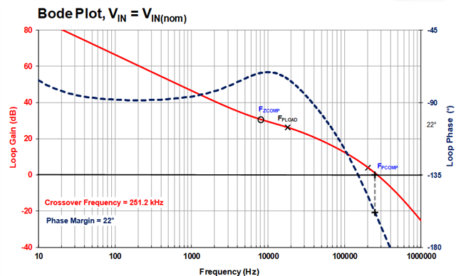

    6. Could you please provide a simple explanation of the Bode plot shown above? Is it better when the dashed line is closer to the red line, or when the dashed line shows a smoother variation? We are mainly concerned with the system stability.

  • Hello Yuming
    DEMB must be connected either to AGND or VDDA. Connect it to VDDA for FPWM mode, while DEM mode can be achieved by connecting it to AGND.
    For practical stability, we recommend keeping phase margin above 45 deg. However, to have sufficient margin 60 deg is recommended

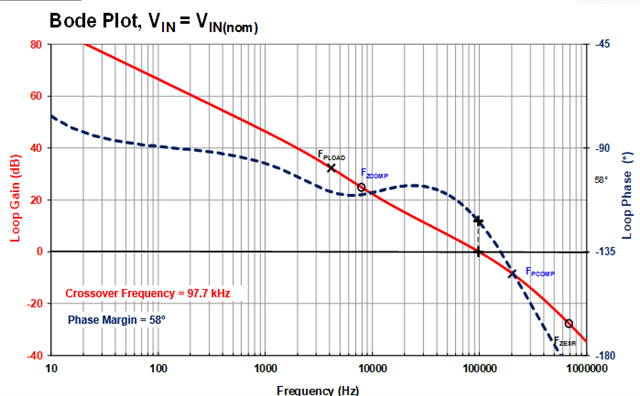

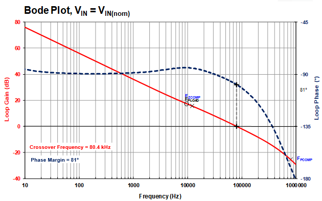

  • Hello Yuming
    Here are my comments on unanswered question.
    Our design target is a 4-phase synchronous buck converter with a 15 V output and a maximum load current of 70 A. Could you advise on the required amount of output capacitance to ensure stable operation?
    Output cap used derates roughly 70 % at 15V output, giving only 53 uF cap at the output.
    With current combination of output cap and compensation network converter is unstable
    I would suggest increasing cap to 12*22uF and using following compensation network for starting values.
    Rc1 5.1 kOhm
    Cc1 3.3 nF
    Cc2 33 pF
    Bode plot with 12*22uF + above compensation network
    You might need to optimize the compensation network based on experimental bode plot and transient response.
    Is this configuration appropriate, with 0 Ω gate resistors for both turn-on and turn-off on the bottom FET, and 7.5 Ω for turn-on and 0 Ω for turn-off on the top FET?
    If ringing is not severe at Top FET gate, resistance can reduce below 5 ohm. 4.7 ohm can be sed as starting value.
    For practical stability phase margin of above 45 deg is considered good enough. However, to have sufficient margin from instability and critical damped response PM of 60 deg is recommend.
    Hope this helps
    Thank you
    Onkar Bhakare
