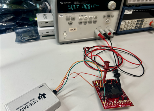

I am trying to use the BOOSTXL-TPS65218 to program a TPS6521815 for use with a Zynq7010 FPGA.
The instructions in the BOOST User's Guide (slvubh5) say to use a MSP-EXP430F5529LP as the USB2ANY interface for the TI IPG-UI tool.
Before that can be done, it says to load new firmware on the Launchpad.

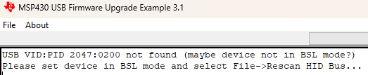

Firstly, the stated firmware upgrade example doesn't exist. I saw elsewhere that the Python upgrade example included in the USB Developer's Package is to be used.
The tool doesn't recognize the Launchpad (I have held the button S5 "BSL" down when connecting to USB):

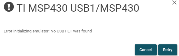

I have tried to use UniFlash to load the USB2ANY firmware, which also failed because it doesn't recognize the USB-FET:
Is there any particular reason why this firmware needs to be loaded via the USB bootloader? Is there a better/current suggested way to load the .txt firmware onto this Launchpad? Or do I need to use this Python USB firmware tool?
