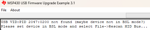

Firstly, the stated firmware upgrade example doesn't exist. I saw elsewhere that the Python upgrade example included in the USB Developer's Package is to be used.

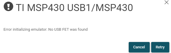

The tool doesn't recognize the Launchpad (I have held the button S5 "BSL" down when connecting to USB):
I have tried to use UniFlash to load the USB2ANY firmware, which also failed because it doesn't recognize the USB-FET:
Is there any particular reason why this firmware needs to be loaded via the USB bootloader? Is there a better/current suggested way to load the .txt firmware onto this Launchpad? Or do I need to use this Python USB firmware tool?

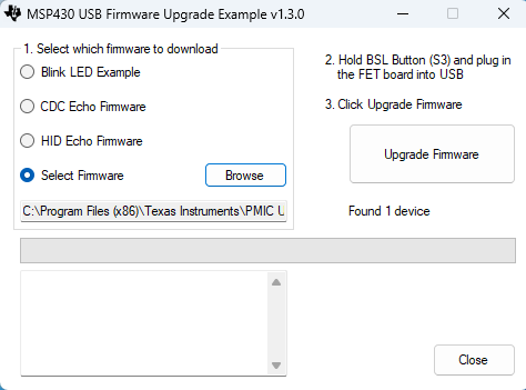

  • Hi Grebe,

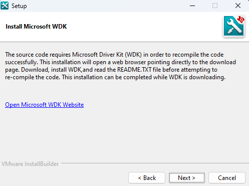

    Please try the direct download for the Firmware Upgrade Example here:
    https://dr-download.ti.com/secure/software-development/application-software-framework/MD-WFl403n8LD/5.20.07.01/MSP430_USB_Firmware_Upgrade_Example-1.3.1.2-Setup.exe
    This is also in the USB developers Package, named as "Firmware Upgrade Example (Windows-only Commercial licensed)" in the latest 5.20.07.01 release.
    This is a windows-only commercial licensed and may require you to download Windows SDK and Windows DK. Instructions will pop-up with the installer:
    After successfully installed, please run the BSL_USB_GUI wherever it was downloaded to (C:\ti\msp\MSP430USBFW_1_3_1_2\MSP430USBFW)
    Select the USB2ANY_2.7.0.0_LP.txt firmware file.
    Hold down BSL button while plugging in the USB.
    Wait until GUI says "Found 1 device"
    Upgrade Firmware.
    I've just tried out this process myself and was able to run it successfully, so let me know if you encounter any issues with the process.
    I'll also be looking into updating the SLVUBH5 User Guide to reflect these changes. Thank you for reporting this issue.
    Sarah

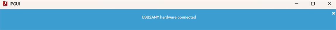

    Thank you for your attention to this. I was able to flash the MSP430 Launchpad eventually. It was just an issue of multiple bad USB cables...

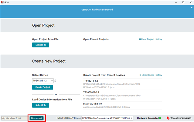

    Further following the instructions in SLVUBH5, on page 10 it says to run IPG-UI to connect to the MSP430 Launchpad (w/ BOOSTXL TP65218 attached). The user guide shows an image like this:
    When I run the same, I see "Hardware Not Connected":
    If the MSP-EXP430F5529LP is not physically connected, the same area shows this:
    so it seems like the device is showing up in some capacity. Additionally, when I connect the device, the message USB2ANY flashes briefly at the top of the program:
    I am able to select TPS65218-1.2 (which the image on p 11 shows). I do not see the option to select TPS65218D0-spi-1.x, which the written instructions state.
    I clicked through to create a new project, but I am not able to read the registers.
    Can you identify the issue?

  • Hi C,
    The TPS65218-1.2 is the correct project option for TPS6521815. (The -15 is a user-programmable version of the TPS65218D0)
    If you disconnect and re-connect the localhost, does the hardware connection status change/ is there a new pop-up at the top?
    Please also ensure you don't have multiple windows open, or any other program that could also be attempting to read the device.
    Only once the program shows "Hardware connected" then the registers can be read properly
    Sarah

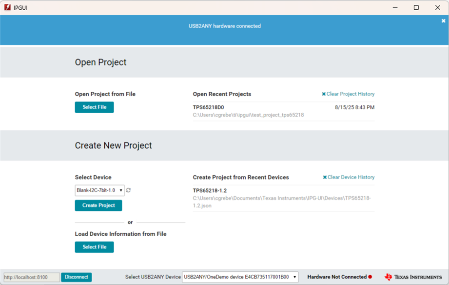

    Sorry if that wasn't clear from my previous post. Yes, when I select the Disconnect/Connect button you've outlined in red, the banner at the top flashes "USB2ANY hardware connected" for about 5 seconds. The banner then disappears. Is it supposed to stay there if functioning properly?
    The bottom message "Hardware Not Connected," remains through the above actions.
    I am inferring that the two messages are referring to different hardware:
    - the top message means the MSP430 Launchpad is connected (running USB2ANY firmware).
    - the bottom message means that IPG-UI does not detect the TPS6521815 in the BOOSTXL board
    If that is accurate, maybe there are some jumpers that are not correctly placed?

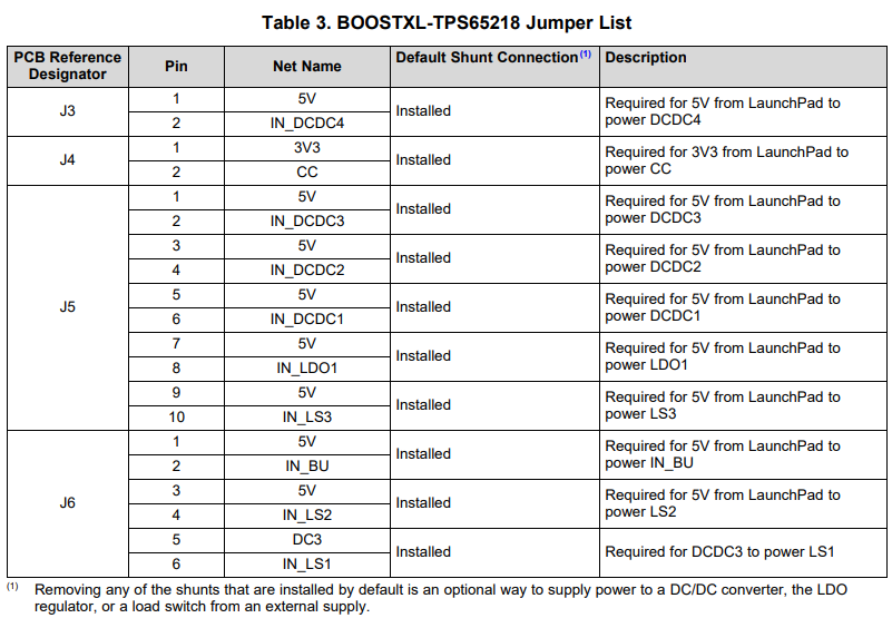

             • Install a shunt on header J20, shorting pin 1 (USB_3P3V) and pin 2 (MSP_3P3V).
    But I cannot find J20 on either board.
    It then says to plug a USB cable into J21 (again not stating which board) - but since there is only one USB jack to be found, on the Launchpad, I think they are referring to J401:
    All of that serves to say that there may be jumpers that I didn't place?
    Going through the earlier steps of the User Guide, it says all of the jumpers J3-6 should already be in place:
    The S1 power switch is on (per p. 8).
    Is this enough information to determine what is going on?

    Please verify you have all the jumpers installed on the BOOSTXL board:

    With only the Launchpad connected after starting IPG-UI:
    • all the same jumpers are in place (everything but RTS & CTS)
    • I see the Green LED
    • The blue "USB2ANY" banner flashes
    • "Hardware Not Connected" and red circle remain at the bottom of the IPG-UI window

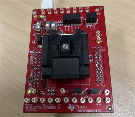

    I then close IPG-UI and remove the Launchpad USB cable. I connect the BOOSTXL to the Launchpad via headers J1-J4. I restart IPG-UI.
    With Launchpad and BOOSTXL connected:
    • all jumpers are in place (5x J5, 3x J6, J7, J8, J9)
    • for reference, the User Guide SLVUBH5 has images of a different BOOSTXL-TPS65218 (revision BMC036E2?) on pp 3, 4, & 9
    • only the Green LED is on the Launchpad. D1 is lit on the BOOSTXL board
    • press/hold/release of the Launchpad RST button causes no change - the blue USB2ANY banner does not reappear; Hardware Not Connected message at the bottom remains

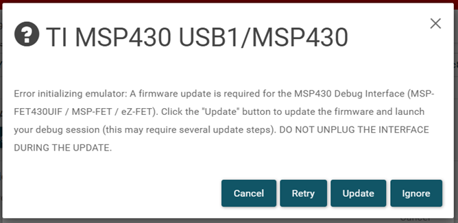

    I did try to run a local installation of Uniflash but it said my MSP-FET firmware needed to be updated:
    I tried to do that and the update failed. A subsequent recovery attempt also failed, at which point I noticed red and green LEDs were lit on the Launchpad. I was able to flash the USB2ANY firmware again using the Python firmware upgrader.
    Could there be something to the message stating the MSP-FET needs to be updated? (Uniflash no longer detects the Launchpad after the previous steps.)

    From what I know, there's not really a way of verifying the firmware was flashed correctly or not.
    I'll have to let the MSP team comment about any known errors with the MSP-FET or Windows 11.
