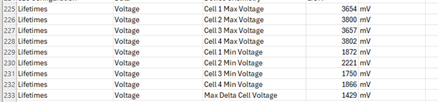

I’m working with a 4-cell LiFePO4 battery pack (12.8 V nominal, 3.6 Ah). I’ve noticed about 10% capacity loss within 4 weeks on some packs. After a quick check, I found that the logs show Cell 2 and Cell 4 reaching 3.8 V, while the others remain lower.

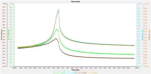

The packs are charged at 14.4 V, 750 mA. I ran a full charge cycle and logged the cell voltages on the graph, Cells 2 and 4 consistently rise higher than Cells 1 and 3, especially toward the end of the charge.
When the batteries are left to rest, the voltages eventually balance out, but the imbalance is clear during charging.
Does anyone know why such a large difference appears between the cells during charge and is there anything I can do to help?

  • Hi Mike,
    I've experienced this with LiFePO4 cells as well.  They have a large voltage spike (just like in your graph) at the end of charge that causes one or more cells in series to hit an Over voltage condition, which ends up preventing full charge.  Even with cell balancing, there is still a chance that a cell can ramp up faster at the end of charge.  This then results with a loss of some capacity.
    What I've done to help this is actually lower the charge voltage.  Instead of charging at 3.6V per cell, I've used 3.5V or 3.55V.
    This has helped me to prevent the cells from hitting over voltage and get to the constant voltage stage, so that I can get to the taper current portion of charging.  It might be worth testing out on your end if possible.

    I did another log last night at 14V, 150mA Termination current and I sees similar results with Cell 2 and 4 reading higher than 1 and 3. But with them topping out at a safer voltage, around 3533mV.
    Here are my main Questions
    - is this perfectly OK?
    - How did a cell get to 3.8V?
    - Internal balancing is at 10mA this sounds really low, should I be using external?
    Mike

  • Hi Mike,
    You could set the over voltage threshold higher to see if you can get past the spike from cell 2 and cell 4.
    I have set the over voltage threshold as high as 3.8V per cell.  That has allowed me to get the charge voltage to a constant voltage before hitting an and allow for taper current to top off the cells.
    External balancing will allow for a higher balancing current versus internal.  TI has some documentation on how to implement external balancing using some additional components.
