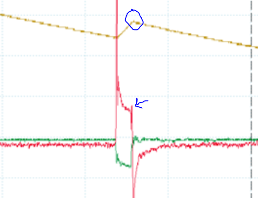

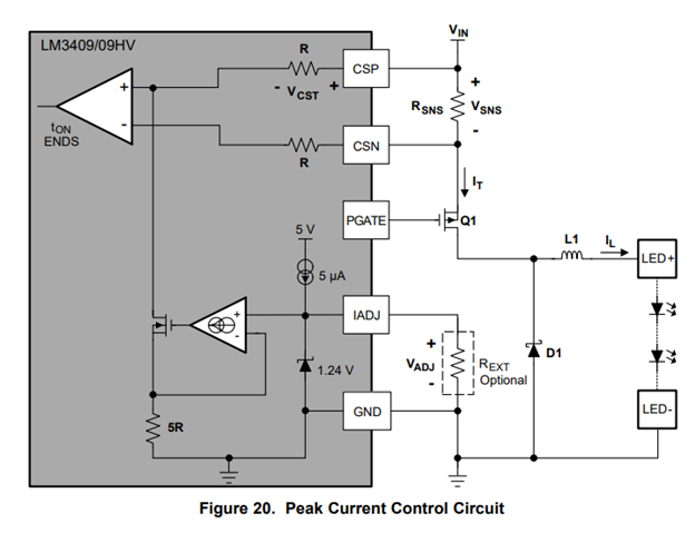

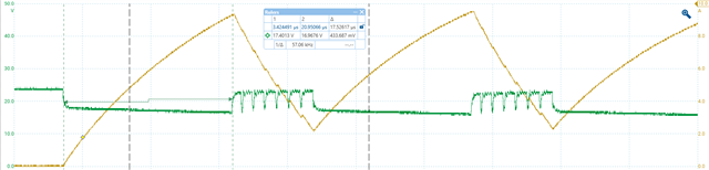

We successfully made designs with LM3409 before, but this one does not work as it should. As you can see below, most of the times when the P-FET is turned on (gate voltage seen in green) the LED current (shown in yellow) barely rises before the FET is turned off again. The time corresponds closely to the minimum on-time specified in the datasheet. I also posted the schematic we are using, the only difference to previous projects is, that we only drive a single LED, meaning V_IN is 24V while V_OUT is only 4V with maximum LED current of 10A. The oscilloscope screenshot is at V_ADJ of 1.24V.

  • Hi Niklas,
    There could be a couple things going on here.
    1.) Your Toff network may not be sized correctly for the 10A output current at this low duty cycle. Note that most LM3409 designs use <5A output current. You can increase the Coff capacitor to 470pF, as this is the typically recommended value. If necessary, you can also increase the Roff resistor.
    2.) What is your desired LED current? According to the datasheet equations, for 25mΩ sense resistor with Viadj = 1.24V, your peak inductor current is set to 9.92A.
    You state the LED Vf is 4V at 10A, but the LED is not seeing 10A with these component values. What diode is used? What is the minimum Vf at the expected LED current? This may affect your duty cycle and min-on-time calculations.
    I do not see any capacitance at the output. Are you applying shunt-FET dimming to the LED?
    3.) Also keep in mind the minimum ripple requirement. For 25mΩ sense resistor, you require almost 1A of ripple. Increasing your Coff to 470pF will also increase your ripple.
    I recommend double checking your component values with the datasheet equations.
    4.) On your initial pulse, the peak current sense is triggered when the inductor current reaches 4.697 A which is less than half of your set point. Are you sure the Iadj voltage is set to 1.24V?
    I notice your re-circulating diode has a very high junction capacitance, especially at low reverse voltages. It is possible that when the PMOS is turned on, there is a large current spike charging the diode capacitance that triggers the peak current sense while bypassing the inductor current measurement. If you have a high voltage differential probe, you can take the differential voltage measurement directly across the sense resistor to determine if the peak current threshold is reached.

    The purpose of this circuit is to drive a single LE D P0MQ with average currents from 0.5-8A set via the analog dimming function. I attached the sheet I used to calculate the parameters here: LM3409 calc sheet.xlsx . Let me know if you need additional information that is not provided here or in the schematic I attached in my previous image. The missing output capacitor is an oversight on my end, but we had a previous project work just fine without one.

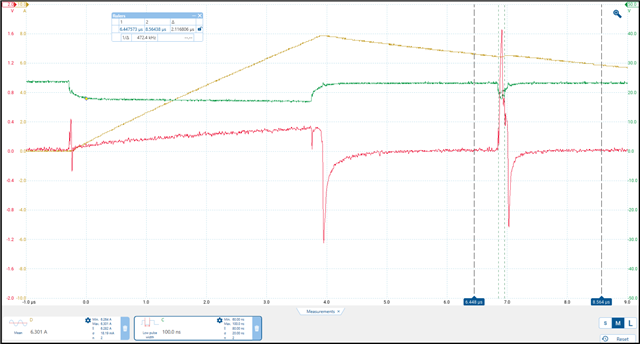

    Addressing 4) : The 4.697A shown in the picture are the average current over one "cycle", the actual peak LED current is 8A. Measuring I_ADJ did give ~1.22V.
    Here are some of the additional measurements you requested:
    After writing my message yesterday, I checked what would happen if I connected four LEDs in series instead of just one, but saw no real change:
    We only have one differential probe rated for 24V, a HZ 109, and even though I used the shortest cables I could get away with, we see substantial voltage spikes:

  • Hi Niklas,
    Thanks for the additional measurements and information.
    I can see in your differential measurement that you are getting spikes over 1.6V. The peak current threshold is triggered at ~250mV. These voltage spikes are due to high inrush current that charges the very large capacitance of the diode and PFET. Normally there is a "blanking period" in which the threshold is not triggered due to short-duration inrush current. However, your differential Rsense voltage remains high due to inrush for longer than the minimum on time which is longer than the blanking period.
    Your PFET is rated to 100V and the diode 65V. This is way to high for this 24V application. Note that there is a relationship between the voltage rating and the capacitance. You will likely need to select smaller components that have a lower voltage rating and less capacitance. Essentially, the large capacitance is causing high inrush currents that are false triggering the peak current threshold on every cycle.

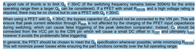

    Your PFET gate charge is also very high at 60 nC. There is some guidance in the datasheet on a method to reduce false triggering due to PFET input capacitance. However, even with this change I believe your diode capacitance would still cause the comparator to trigger.

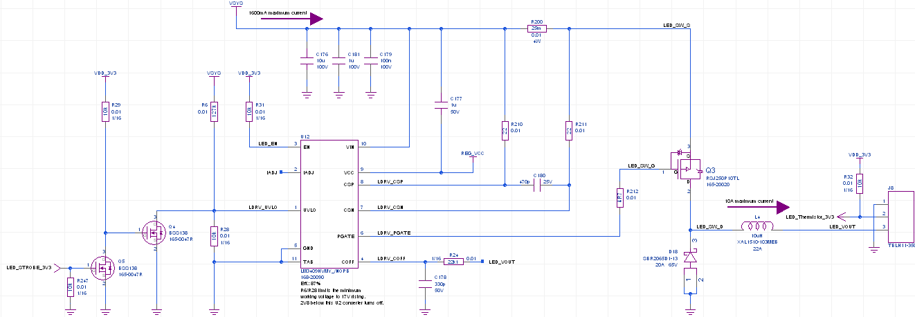

    Your calculation sheet seems fine except that you chose a 25mΩ sense resistor instead of the 29mΩ resistor that was calculated.
    I also recommend including output capacitance on your next design revision. LM3409 does not "need" output capacitance to function, but based on your output voltage measurements it looks like it would help reduce your output ripple quite a bit.

    I see what you are saying about the transistor and diode being the wrong size for this application. Could you maybe quantify the blanking period you mentioned?
    I did the suggested modification to the bypass capacitor and while it did improve the situation somewhat (the pulses for T_on are now almost twice as long at 190ns), the current is still not regulated correctly.

    I'm glad modifying the bypass capacitor helped somewhat... If you changed the FET after modifying this cap, I wouldn't expect much of a difference as the gate charge current is already being bypassed. However, this change could still improve your overall efficiency once we get the desired operation.

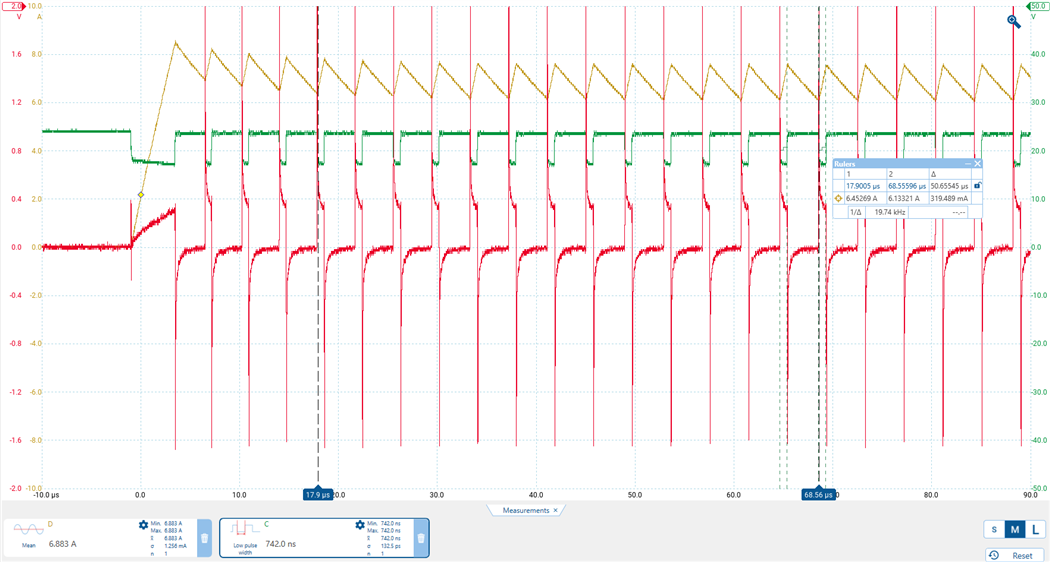

    I got the new diodes, but there was no measurable difference to the STPSL15L45CB I tried before, so it seems like those were already "good enough". Furthermore I tried both 1nF and 4.7nF differential filter caps:
    1nF is reaching 520ns:
    /resized-image/__size/2858x1880/__key/communityserver-discussions-components-files/196/Pumbaa-LED-driver-1nF-filter-2025_2D00_08_2D00_27.png
    4.7nF is getting to ~680ns, where the switching behaviour seems almost normal:
    /resized-image/__size/3018x1878/__key/communityserver-discussions-components-files/196/Pumbaa-LED-driver-4n7-filter-DAC-at-250-2025_2D00_08_2D00_28.png
    However, I do see that the first few pulses are higher, before the system reaches a steady state at ~7A average current:
    /resized-image/__size/3530x1892/__key/communityserver-discussions-components-files/196/Pumbaa-LED-driver-4n7-filter-DAC-at-250-steady-state-2025_2D00_08_2D00_28.png

    It looks like the increased differential filtering helped quite a bit. I am curious if this filter can be further optimized to improve the response.
    I'm not sure about the first few current pulses... I've heard that sometimes this can be caused by the current probe itself, something to do with the flux settling. I would also check your input voltage at the pin during these first pulses to make sure you have enough input cap to prevent the voltage from drooping too much.

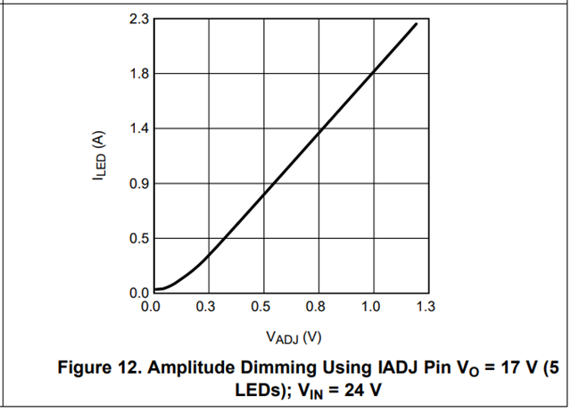

    What is your IADJ voltage setting? The IADJ setting is not very accurate at low voltages, we typically recommend an IADJ voltage between 140mV and 1.24V. 1/20 analog dimming ratio is fairly high, could you use another dimming method such as PWM or shunt-FET?
    You are operating at a pretty low duty cycle at the high current setting. At the low current setting I assume your output voltage is significantly lower as well. You could try placing another LED in series to see if this helps at all.

    first of all some background on my dimming requirements: The application requires analog dimming, PWM or shunt-FET methods are not suitable. For this LED my actual dimming requirements are 1/8-1/10, but this design is also supposed to work with a LZ4-00R608, which has higher forward voltage (~11.9V) but also much lower currents. That is where we got the 1/20 dimming requirement. However, at this point I think the best I will be able to achieve is have the same layout with different BoM-options for the two LEDs.

    I also tried to see if anything changes if I disconnect the I_adj pin and leave it floating:
    /resized-image/__size/3010x1880/__key/communityserver-discussions-components-files/196/Pumbaa-LED-driver-4n7-filter-cut-DAC-cap-normal-diff-probe-on-filter-2025_2D00_09_2D00_01.png
    With this change the current spikes even higher, even though what is most surprising to me is the first ramp, where the current does not reach 10A as it should and even more important the differential voltage seems to follow this very well. I would have expected to see a differential voltage of 1.24V/5 = 248mV before the gate is shut off. Actually, I never saw a voltage of 248mV without disconnecting the I_adj pin and even then just on some spikes that probably contain a good amount of measurement error due to EMI spikes.

    If you want to take a look at the layout, I cannot publicly share the design we were analyzing so far, but I made a test board with the recommended changes, that I would like your feedback on. I am hoping, that the compact switching node and tight switching loop will improve the situation.
    schematic_EPM2A - LM3409 LED driver Eval_variant_Full.pdf

  • Hi Niklas,
    The layout looks pretty good, I only have a couple suggestions...
    First, you should remove the thermal reliefs from your input connections (VIN and GND) and use a direct connection. It looks like the rest of your power path uses direct connects which is good.
    I notice your PGATE trace width is ~8mil or less. Its not a long trace but increasing it to ~12mil could help reduce the inductance. It looks like you have plenty of room to widen this trace. I'm not sure if we addressed this previously, but we typically recommend to start with a 0-ohm gate resistor and increase the resistance if necessary.
    I would also consider how you want to manage the heat as this is a very small board with a lot of power. Do you plan to connect a heatsink to the bottom side? I can't tell from the Gerber files if you have thermal vias but I recommend placing some at the D1 and Q1 pads. Thermal vias in the ground pour around these component could also help.
    I understand you do not want to share the other design on the public forums. If you would like feedback for the other layout, feel free to send me the files directly and I can response over private chat.

  • Hi Zach,
    the new boards arrived and they work as intended. Seems like we had a major layout issue. Everything up to and including the dimming factor improved, I can get the blue LED down to ~600mA even with the increased differential filter capacitor.
    Thank you for your help on this journey to a working design.
