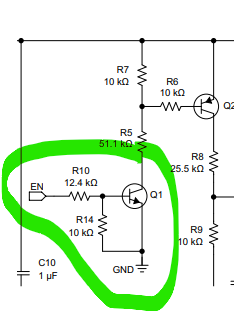

One of my customers has the following question.
The TI parts that I am using are LM5116, LM5145 and LM5162. Attached is the schematics for the supplies that we are using. The designs have been taken from what was generated by webench.

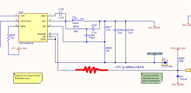

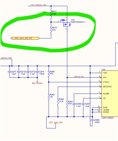

My design requires a couple negative voltage rails.  The designs have been based on Webench designs.  One thing that I am unclear with these designs is how the UVLO and EN pins operate without a ground reference or rather now that ground is now relative to a logic signal that is. Do these logic signals effectively need to be made floating to work?  I presume the PGOOD would also need to be clamped to ground, otherwise it may be pulled below system ground.I have attached our schematics on these for review/commentary.  The -30V supply has enable circuitry that I believe will work, the -15V supply I have not corrected yet as I await your commentary.

    EN input is already level-shifted using this circuit. It looks okay. Please make it sure that '-30V_ANA_ISO_EN' is open-drain/open-collector output
    LM5116 doesn't provide PGOOD.
    LM5164's PGOOD is protected by Zener diode now when the PGOOD pin is floating. This circuit needs a current limit resistor when PGOOD pin is connected to -15V_ANA_ISO
    To see more examples, please refer https://www.ti.com/lit/an/slva540/slva540.pdf
