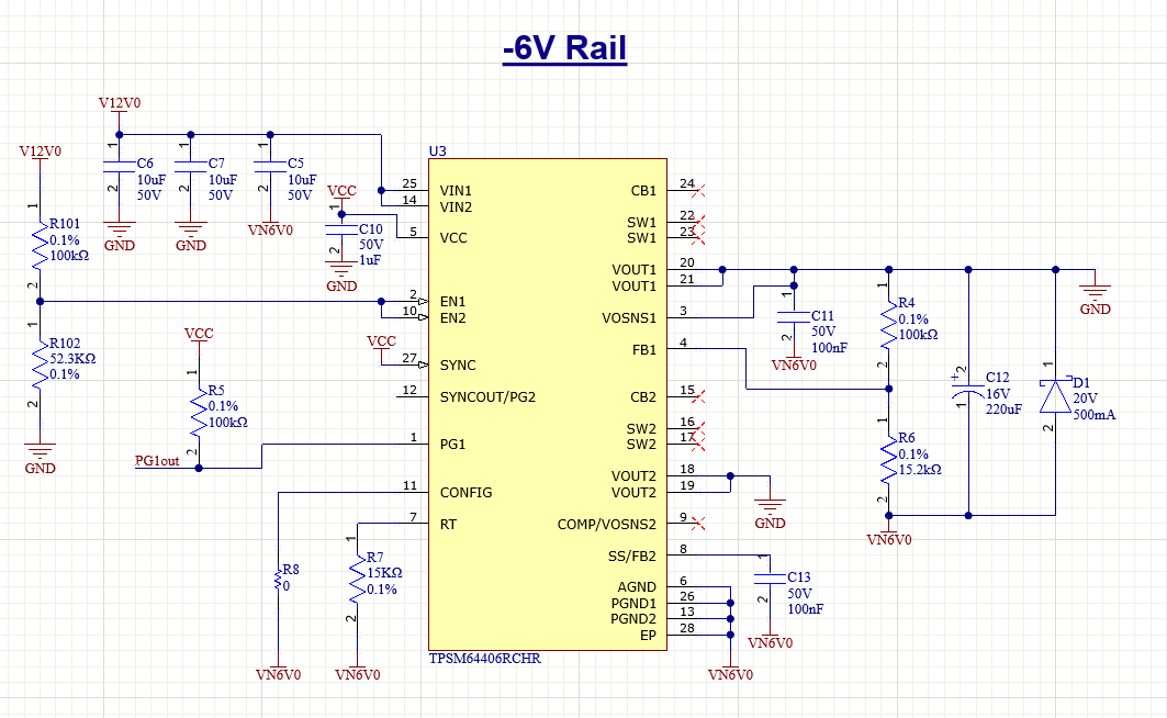

Hey Team,
I'm from the Medical SEM team and I'm working on a custom board for a customer. We want to use the TPSM64406 on this board, and I'm wondering if it would be possible to make +6 / -6 power rails with this part. I saw that it mentions "Negative output voltage capability".
I was trying to make a custom design using the WEBENCH Power Designer tool, but it didn't look like the TPSM64406 was available for support on their.
Could you give me some assistance here please?
Conditions:
Vin = 12V
Vout1 = +6V  @ 2A
Vout2 = -6V @ 2A
Thank you for your help!
