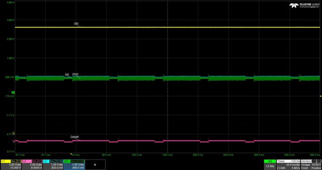

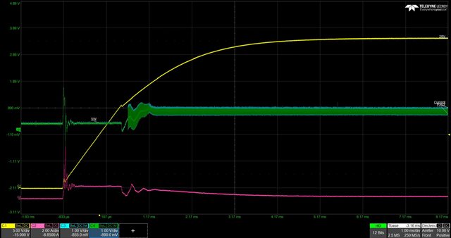

However, when applying 28V on the TC54, the component does not output a 3V3 voltage as we would expect.
The voltage on the SW output is not as expected either and it seems like the component is trying but is unable to switch.
Here is an oscilloscope copy from the startup:
And afterwards once the 28V is established:
Any idea of the issue ?

    Reviewing your waveforms I'm not sure what I'm looking at. Please confirm the following:
    CH1 = Vin?, CH2 = Iout?, CH3 = Vout, currently at about 1V (not 3.3V), CH4 = SW?
    The switch node should be switching between Vin and GND at a duty cycle of Vout/Vin. I do not see this and therefore, there might be a problem with the device.
    Have you tried swapping it out?
    Lets us know if you have made the above design changes/swap out the device and you still have issues.

    Waveform
    Yellow Curve (Vin_nom=28V and Vinçmin=10V & Vinmax=60V)
    Red Curve (Current. Imax =150mA)
    Green Curve: (Vout=3.3V)
    Blue Curve ( Pin 5)
    I confirm the switching node does not switch
    The diagram as is already worked on another board
    We haven't changed the controller yet
    On the other hand, I also propose to introduce a resistor on RT to reduce the frequency because in our conditions of use the component would heat up too much (Tamb=70°C). So we are thinking of putting a resistor to be at 900kHz of Fsw
