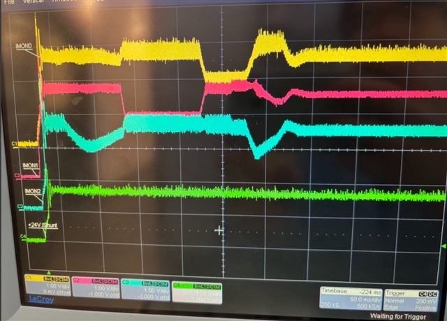

Regarding my previous question which is now locked, we've finally had time to do more testing on our system and upon doing more detailed testing we noticed some things that we think might be unusual.
1)The time for each of the individual channel's current to settle into steady state is very long, >50x the voltage settling time. Voltage settles in approximately 7ms but current of the individual channels settle roughly after 350ms regardless of the size of the current step change.
2)The current sharing stabilizes in what we think might be an unusual manner.   After the initial section that looks like an underdamped oscillation (approx the first 10ms or so), until the currents reach steady state it looks more like some sort of a piecewise function.
3)All this behavior is seen with 2,3, and 4 power supplies enabled
4)I should note we are using a low side current shunt with an INA293A2IDBVR between the shunt resistor and the CS+ inputs to improve handling of negative inputs beyond the -0.3V specified in the UCC29002 datasheet.
The attached image shows 3 of the 4 CSO lines (IMON0-2 in the image) and the 4th trace is the high side shunt prior to the electronic load (sum of all 4 supplies). While not shown, voltage stabilizes within 7ms of the initial rising edge and the 4th CSO line behaves similarly to the ones shown.  Please ignore the large amount of noise that can be seen on the CSO line traces as we've proven that that is a measurement artifact
Is this all expected behavior?  Also how can we improve the response time to reach steady state?  My concern is that under heavy load, the duration of time where the currents are unbalanced is potentially long enough for one of my supplies to trip over current protection.

    However, the gross "piece-wise" variations over most of the 300ms of settling time are NOT expected inherent behavior of the UCC29002 controller, but must be instigated by some external influence (maybe noise on the LS inputs of each device?) of the current control.
    It is expected that the current response time should be slower than the voltage loop by at least 10~20 times.
    This involves accurately determining the power modules' V-loop 0dB cross-over frequency (fco_mod) and setting the EAO response to at least 1/10 of that fco_mod.
    Please ensure that this was done.
    Notwithstanding the previous comments, the UCC29002 is designed to start up by aggressively driving high adjustment to the module output voltages to get the currents up as soon as possible, then they settle out to equilibrium from there.
    An alternate version of the IC UCC29002-1 has the aggressive start-up disabled and the EAO starts from 0V and gradually increases, so the sharing gradually increases to equilibrium.  It may take a bit longer than the aggressive manner, but should be more smooth and calm.
    However, this difference does not account for the behavior seen in the screenshot, in my estimation.  I think something else is going on there.
    But maybe you can try the UCC29002-1 to see if it helps to avoid it.

    After more experimentation, I've discovered that the piecewise variations only appear if the system goes below a minimum load current. In this case I've found it's about 1A.  If I go below 1A the next change in current shows these piecewise variations.  Even a small jump from 0A to 1A causes these piecewise variations.  However if I stay  above 1A, even jumps upto 18A produce essentially a square step on CSO and LS lines.   Any other thoughts on how to correct this or push the minimum load current lower to avoid this issue?  I've tried changing the current amplifier gain from 5 to 10 (along with any other required components for EAO compensation) and there was no change in minimum load current.

    It is possible that at the light load of <1A, the 4 modules might "juggle" current such that some negative current flows into one or more of the modules and the INA's take some time to sort out and settle to a steady-state, depending on how much negative they might have be subjected to.
    If your modules are capable of accepting some negative current, this might be the root cause of the behavior.
    You may need to consider output blocking diodes to prevent reverse current if this situation cannot be tolerated.
    Please investigate and see if this might be the cause.

    However, as a sanity check, I removed the external shunt amplifier and wired the shunt resistor terminals to match figure 7-2 in datasheet Rev J for high voltage low side current sensing.  I originally had the INA293A2IDBVR followed by a voltage divider as the input to CS+. This has been changed to the equivalent resistance as seen by the CS+ pin in order to maintain the same gain and keep all other components the same.  With this configuration, the piecewise waveforms are still being generated when starting with currents below 2A.   Also, at low currents I think there's always going to be the possibilty of backdriving a supply simply because of power supply output tolerances, +/-2.5% in my case (Radj has already been selected to cover this range).  I could trim them to be closer together as an experiment but not for production.  Any other suggestions to try?

    -Trimming the supplies further apart had no change either.  Interestingly though, even if 3 supplies were trimmed down to the minimum and one supply trimmed to the maximum, one of the trimmed down supplies almost always matches the CSO waveform of the trimmed up channel.  It was not always the same trimmed down channel that matched the trimmed up one.
    -We already had Radj set to 6-7% to cover the needed range.   When we reduced that, there was no change in minimum load either.
    -removing our external shunt amplifier (shunt resistor adjusted so none of the other components needed adjustment) had no change in minimum load either
    What did help was boosting the CS+ input voltage by reducing the voltage divider that followed the INA293A1 by about 30%.  This reduced the minimum load to 0.4A.  When load sharing only two supplies the min load was only 0.05A but with 4 supplies the min load was upto 0.4A.
