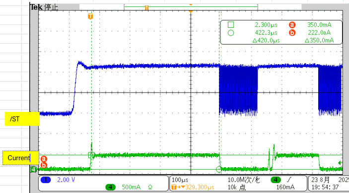

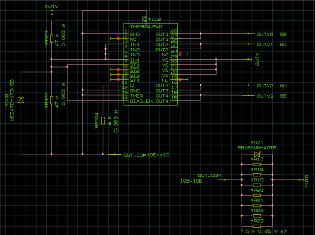

I meet a problem about /ST repsonse time.
In TPS4H160-Q1 datasheet, it reocrd the /ST will repsonse after current limit occur.
Is the current limit means the over current occur or thermal shutdown occur?
Following is my waveform and schematic,  I set the limit current to 0.3A by a 6Kohm resistor.
It seems the /ST repsonse after the current limited and the response time is much longer than 180us, do you have any idea about what factor will affect the response time?
